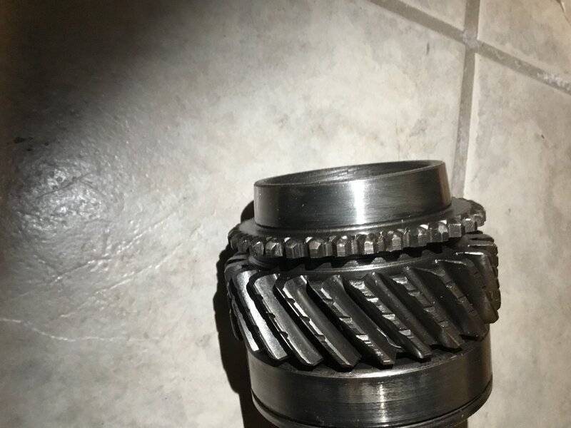

Is this inout shaft usable? Or replace.
That's high gear.
If it were for my own vehicle, I'd likely sharpen the points and try it, prob be okay. Replacement is fairly easy .

You might get away with it... But teeth like that not only effect the shift into high gear but also can cause it to pop out of gear.... It's available, in the past availability was always a problem... If you are strapped for cash patch it, if you aren't a starving car guy replace it...

Availability is keyword on that particular choice gear.
I've had to spray weld the brg surface and dress teeth as shown, to make a trans serviceable, cuz of no availability.
Glad it's avail .
Never had a Mopar trans pop outta gear.
Cheers .
The only input shaft, since 1970, that I have ever replaced had all the teeth ripped off it.................. by me, lol.
I can make those clutch-teeth, in the pic, fully operational in under 5 minutes. But fixing the slider takes a lil longer, and the brass ring will need a new home.

having rebuilt hundreds of those transmissions, I can tell you that the degree of pointiness, with a good-working brass-ring, hardly makes a difference.
However, once a slider tends to kick into neutral, under power, it's game over, the trans has to come down; and all all of the teeth will need to be back-cut on the power side.
But, if it kicks out under deceleration, there are usually no more than two sets of four of them involved in kicking out; so those eight will need to be back-cut.
Exactly which teeth will need to be cut, will be evidenced.
I do this with a hand-held electric die-grinder like a "dremel" but with a longer nose on it that is able to operate at a better and deeper angle. I use a tiny cut-off-type wheel, about 1inch in diameter, if you want to try it.
