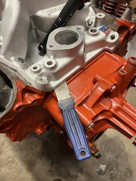

I don’t remember how much was taken off the intake side of my stock iron heads because it was years ago, but I milled the chamber side at least .060. I had test fit the intake before and thought it was going to be okay, but last night, getting ready to install it for good, it lines up the bolt holes perfect sitting on the china walls and fits flush to the intake face of the heads; without gaskets. I know I have read on here in past threads to cut the face of the manifold in this case the thickness of a gasket plus a cleanup cut. (Sorry I don’t remember which of you gents to credit with this but I did get some good info on fitting intakes from reading a couple of threads.) Problem is, my local machine shop can’t machine intakes and I am way past stripping the block back down to trim the china wall; especially just to have a void to fill with rtv. I really don’t want to strip the heads back down either so: what’s wrong with using rtv to fill the imperfections and bolt it on without a gasket? I will check some more to see if the runners line up but all the bolts start easily by hand. If I do this that leaves open using this air gap in the future with aftermarket heads.

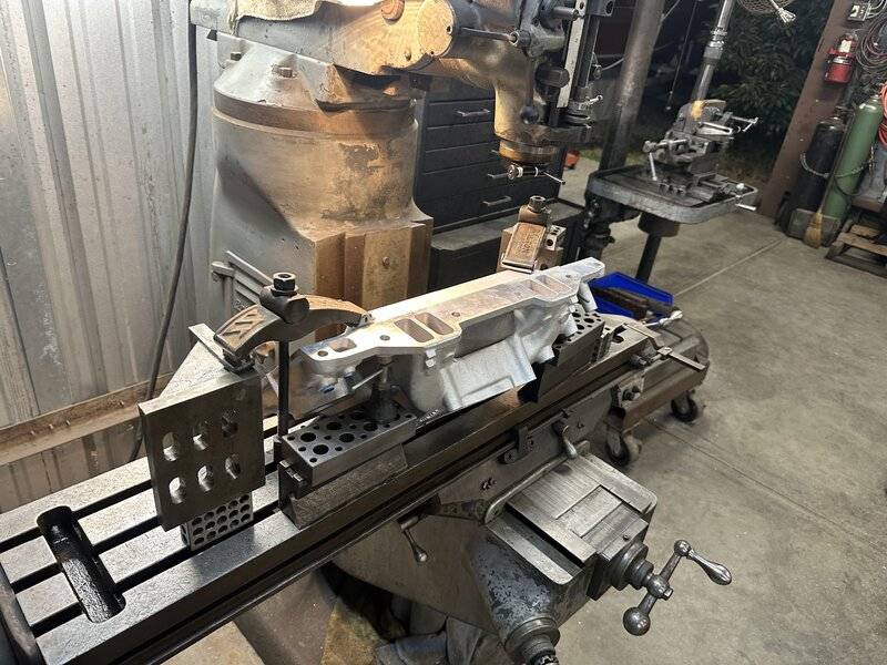

Find a shop that can cut the intake.
Most overhead style resurfacers that have a rollover fixture can do it, or a guy with a decent sized knee mill and enough tooling, and who knows how to use it.
You’re right, I can find a shop, either in TN or in Ohio, and I’ll be in both this month. But; my question is what’s wrong with using something like Permatex Permashield? They recommend it for intake manifolds. I know that one problem with rtv is getting a part back off; but other than that? Permatex advertises parts put on with Permashield to be easily removed and replaced.
Correction, upon closer examination it seems Permatex only recommends Permshield as a gasket dressing for an intake manifold.
We just cut one a few days ago for @jedrattle Fixturing was a pain in the *** but no one (machine shops) would touch it. This was an rpm air gap on speedmaster heads. We used a .060 edlebrock gasket and had to cut the intake flanges .035. After that it fit great.

I’m glad yours worked out. Certainly an option but I would have to enlarge my steel gaskets’ port openings. The ones I have are smaller ports than the gasket I port matched to. I’ve thought about cutting a paper gasket out to match and dressing each side with a thin coat of black permatex, but the question remains; what does the paper gasket add?

Yes, it sits too high even with the steel gaskets, though most of the bolts will start. Without a gasket all the bolts easily thread by hand.
Just went through this myself. No local shop was interested. We did it on a vertical mill. Took forever to setup but came out good.
Mine was done on a Bridgeport over a lunch hour.
...or have the intake surface of the heads cut...that way any non-cut intake will fit those heads.

I went back to my shop just now and threaded in four bolts semi tight, with no gasket. All the bolts go in easily. I looked inside with a cheap Harbor Freight bore camera and saw no problems with alignment. The head has been gasket matched, but not the intake as yet so all I could tell is that there is no ledge going into the head. The angles of the faces of the head and intake are spot on. There were only two places around the perimeter where there is any gap at all. Couldn’t find my feeler gauges at the moment so I stuck a putty knife in, 0.023 inches thick. Pics attached. The intake fits perfectly at the back. The two gaps are one side of the front china wall and the opposite side top of intake. I think if I do machine it the geometry is okay so simple cuts only.

Machine the intake manifold face the thickness of the gasket on each side and send it.
If your shop can machine a cylinder head they can do the intake.
If they tell you they can’t do it go find another shop.

I think mine only got a .010 or .015 slice to make things right. It wasn't much.
