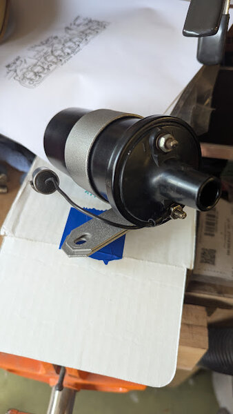

The project is a 71 Dart getting a 318 to 340 swap. The engine is allegedly from a 72 Challenger. When I bought the car, it was a roller with several pickup loads of parts and the engine had been partially disassembled already so I don't have a reference. The question is this . . . . the coil had a condenser with an eyelet pigtail attached to the + terminal of the coil. The pigtail is just long enough for the condenser to get attached at the coil bracket mounting boss on the intake manifold. Not wanting to trust anything I can't confirm, is this condenser needed? I have a couple different versions of the wiring schematics including the factory service manual and none of them show this condenser. Thanks!

It IS necessary, and it's not just for radio noise. The condenser (capacitor) helps provide a low impedance path to ground during the spark event. When the points open, the coil is magnetically charged. The cap INSIDE the distributor has zero charge because the points were closed. The magnetic field collapses, and causes a generating effect in the coil primary. This causes a current flow from ground up through the distributor cap and charges it up. Meanwhile, the radio cap "helps" to provide a short, low Z path for that circuit. When the magnetic field runs out of steam, the dist. cap is charged, and discharges through the coil, re-charging the magnetic field. The repeats over and over, until the load (the spark plug) on the coil causes this "ringing" oscillation to finally peter out. Then the points close and starts all over again, battery current recharging the magnetic coil field.

In short, it is not necessary for basic ignition operation. More details about its function and usage are described in the following.
The radio interference suppression capacitor attached to the coil is one of three interference suppression capacitors in the ignition and charging systems for contact point ignition systems. These capacitors, also referred to as condensers, filter transients on the +12 volt ignition, charging regulation, and supply feeds at points that might cause radio interference, or noise. These capacitors are described in the following:
  • At the ignition coil: A capacitor is connected between the coil primary, or positive (+), terminal and ground by mounting with the coil bracket. The capacitor filters transients that appear on the primary wiring from the opening and closing of the contact points, and subsequent coil magnetic field build and collapse. This is separate and different to the condenser in the distributor itself that assists with coil primary current during field collapse and potential contact point arcing.

The capacitor at the coil, or later integrated in the wiring harness, will not affect the ignition itself if removed from a point system. It likely will not negatively affect a factory electronic ignition if removed, but transients could lead to false triggering in the ECU if large enough. The capacitor is not a parasitic device in this function and should be generally left in place unless there is a specific reason to remove it, particularly if the vehicle is equipped with an AM radio.
The capacitor at the coil must be removed with aftermarket ignitions that are of the capacitive discharge (CD) or multi spark discharge (MSD) varieties.
For a stock point or electronic ignition, if the capacitor in the ignition primary circuit fails open circuit, it will have no effect other than possible radio noise or even less likely ECU false triggers. Although uncommon, if the capacitor in the ignition primary circuit fails as a short circuit, it will shut down the ignition, and could lead to wiring damage.

Yes. 67dart273 explains the function of this additional condenser in the first paragraph of his initial reply. The system will run without it, but it works better with it.
