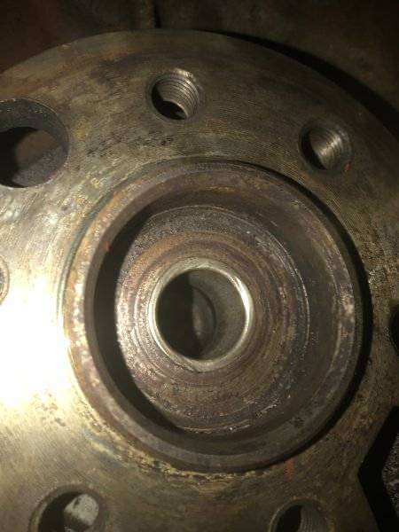

Traded this 833 for my 518, didn't notice this "stepped" input shaft until now while scraping all the gunk off it .....have a feeling it shouldn't be like this‍♂️
PS...I know it's upside-down
If it were mine, I'd polish the shaft then take it, and an original pilot bushing to a machine shop and see if they could make me a new bushing.
Use the later design bearing, instead of being in the deep small diameter hole it is driven into the large diameter hole
It should ride on the undamaged area of the input shaft..

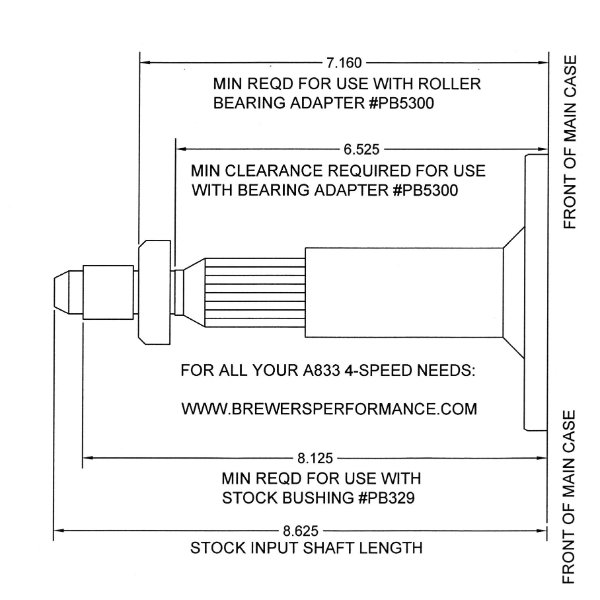

Thinking the OP might want to do some quick measuring to make sure a bearing will be on what's left of the .750" diameter. Picture looks like it should.
Somewhere here Brewers has posted their dimensioned drawing.

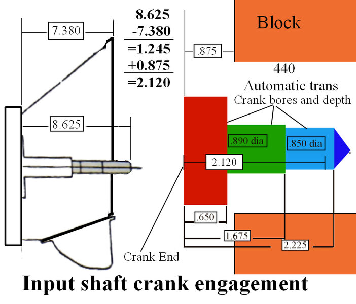

What I've found on a 440 auto crank for some reference.......

Couple more drawings for reference. Looks like you should be able to use the input as-is with this style bearing: PILOT ROLLER BEARING/ADAPTER - Mopar A833 4-Speed Transmission & Component Specialists
