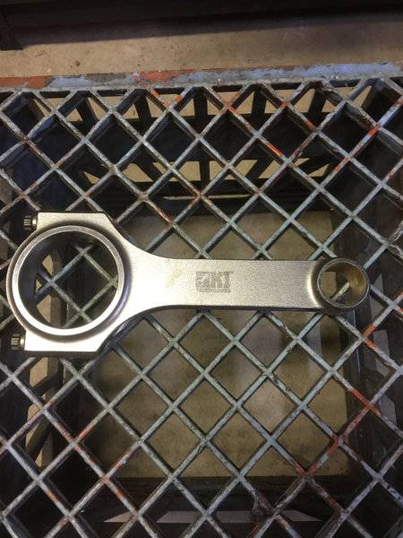

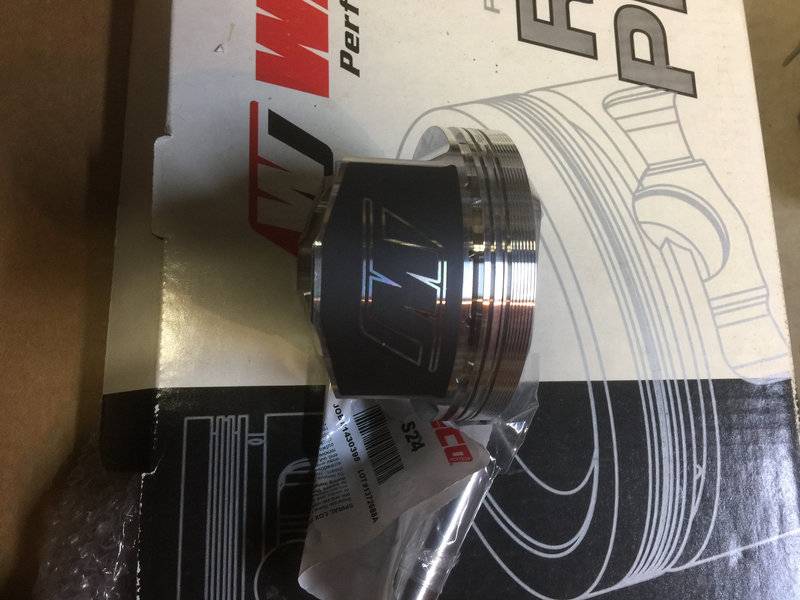

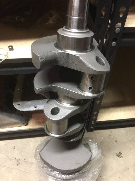

This one will go slowly as I will be sending the 360 block out hopefully next week to get magnifluxed and bored .030 over. I will then bring it home to stroke clearance it, tube the oil galley, and dummy it together to see if and how much I can cut off the deck surface. This one with have some compression lol. I may also dummy in a roller cam to get an idea how big a roller cam I can go with. My best set off Edelbrocks I ever ported are on my Sons engine and they max out at 318 CFM. The set going on this engine will be the set i pushed the pushrod way over and bought .350 offset Harlan Sharp rockers that they made for me. I rairly get a chance to run the full 1/4 mile as my class runs 1/8 mile but I will see if I can get a 9.50 out of it. This should be a fun build. The K1 crank will be a chevy rod journal 4 inch, K1 6.125 H beem rods, and Wiseco Pistons.

The Chevy rod journal is usually with the longer rods for clearance. Was just curious why that journal size? More bearing choices? Gas port pistons?

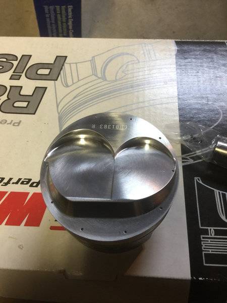

Chevy sized rods require less block clearancing, lighter, and better and more rod choices and usually cheaper. The pistons I bought years ago at to good of a price to turn down. I have a new set of Diamond flat tops here but since I run alcohol I want to add some compression

What kind of compression are you hoping for.
With a 67 cc w2 and a 4.00 crank stock 340 bore and a Ross .100 flat top dome I get 12.7:1 which I am told is just enough for alcohol.

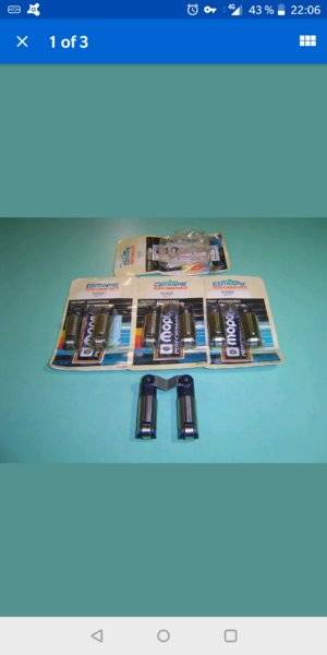

Give some thought to the bushed direct oil feed lifters from Isky or comp cams. I learned that not all roller lifters are created equal.
The comp cams sportman lifter link bars are made of better material
and the axles are staked instead of retained with "C" clips that can fail. These style of lifters are aimed at big lift high spring pressure builds but require certain oil mods to the block.
You can run them with tubing both sides and add small .030 feed holes to get pressurized oil to the axles.
No idea yet but my last 408 that ran low 9.70’s was around 10.5 with flat top pistons and open chamber 340 style Edelbrock heads. I do a fair amount of chamber work on the heads and the decks were never trued up on that one. I’m betting over 13.2 or more easily on this one.
