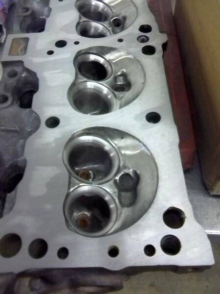

Greetings. Some of you have already commented on my cam/spring questions, so many thanks. These are the J-heads that go with that project. I've been doing some basic bowl/port clean-up, but now have questions about the combustion chambers...
>> There are ridges just below the valve seats on the quench side of chamber (see A & B in the photo). I believe these need to stay, but wanted to ask.
>> There is a triangular bump sticking up between the intake seat & the plug recess that drives me nuts (see C). Can I blend this in?
>> There's a raised step around the all of the seats (see D). These heads had a valve job ages ago, if that matters. Should this step be removed/blended to maintain a smooth surface from the seat exit into the chamber? Seems like that could only help flow, at least on the intake side.
Thanks!
All that stuff can be blended in. ABC being in the combustion chamber won’t really affect flow, but by smoothing those out it will eliminate potential hot spots.
Smoothing D will help low lift flow, a little, if the valve seats are all ready finished be careful you don’t slip into them. Try putting an old valve in while doing the smoothing on D to protect the seats.
C and D need to be blended in. Leave the rest alone. Also you can gently lay back that sharp, pointy edge at C.
