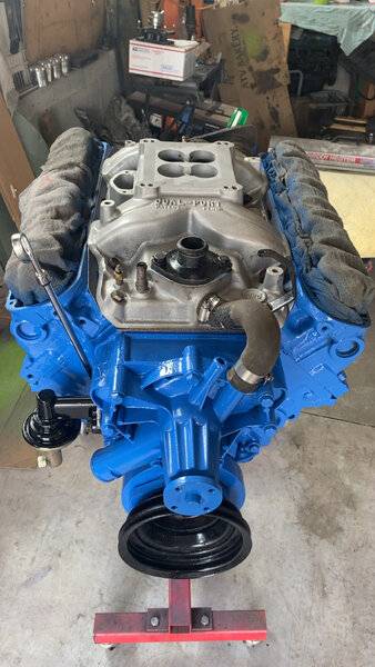

We finished assembling the motor, sans the intake. Gonna prime the oiling system and get it painted all nice and pretty one day soon. Then he'll place the intake. He wants the intake to stay aluminum looking. My opinion is to make it motor color, but it is his, and will look the way he wants it to.

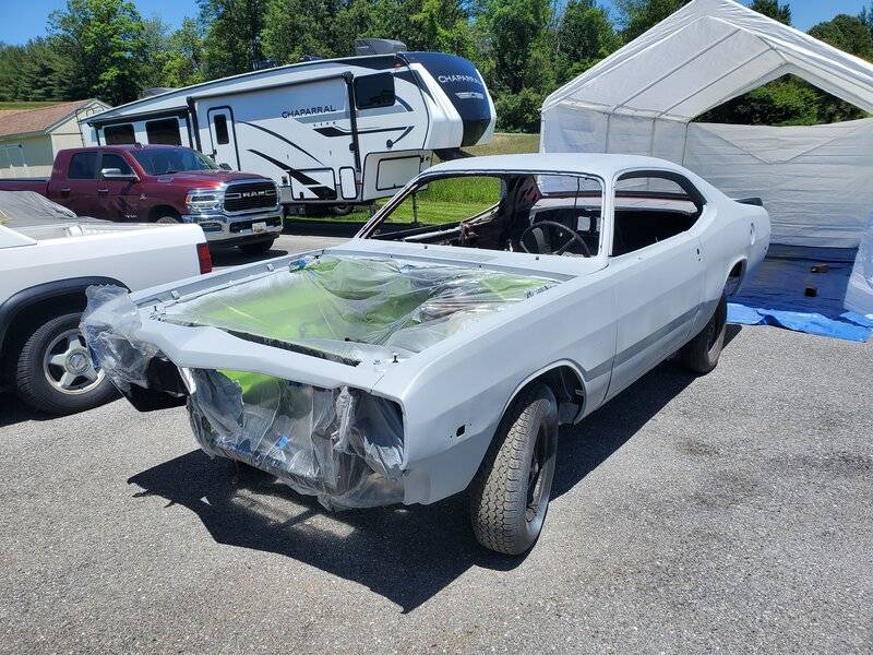

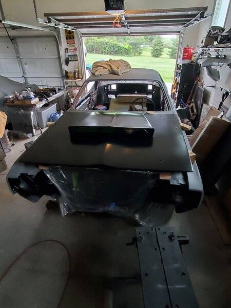

And Monday, we are finally shooting the high build primer.....
if the intake's new why not clear lacquer it? either gloss, satin or matt. it's wash clean that way (easier if gloss). if you don't coat it with something it will dull/tarnish sooner or later however careful you are.
neil.
neil.
He is going to clear it. I'm just old and prefer engine color... LOL

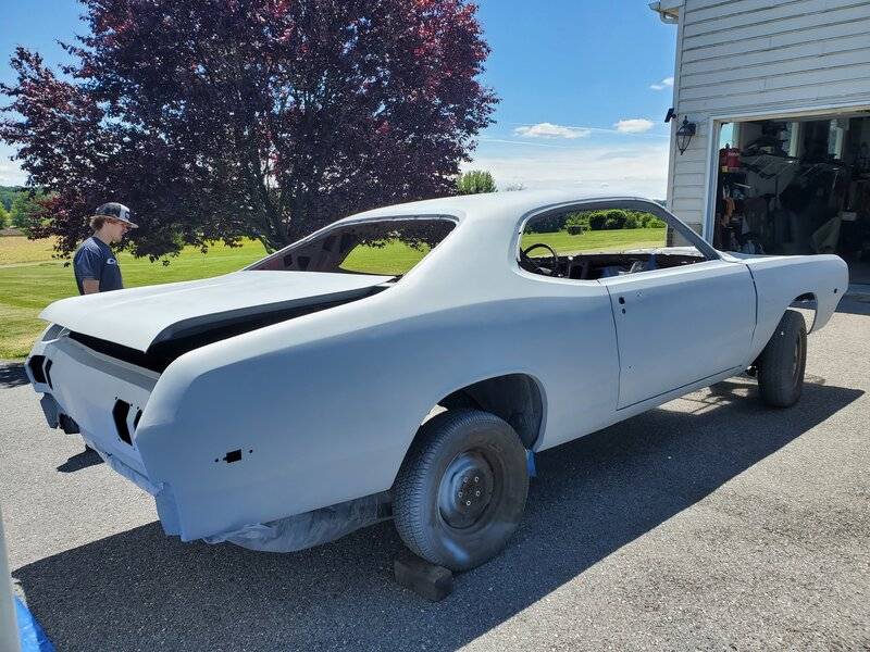

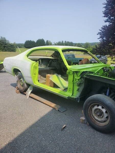

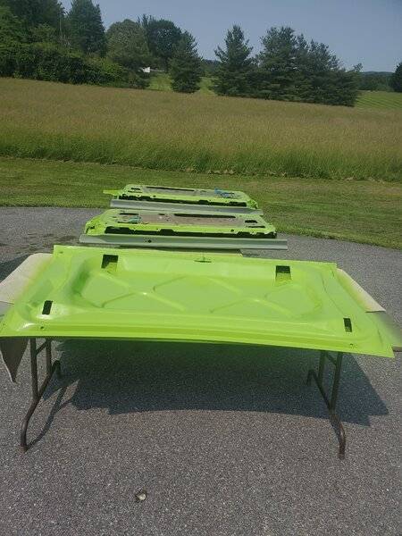

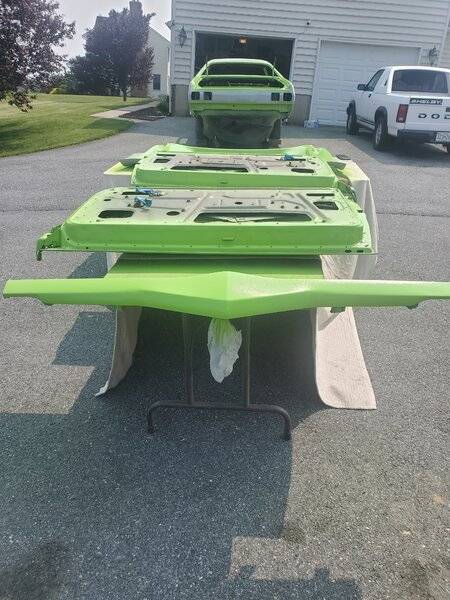

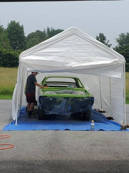

This afternoon, we shot the jambs, window openings, inside edges of the doors, fenders and deck lid. And the beak. For making this up as I go along, the paint seemed to lay down rather nice. If the whole body turns out this good, I'll be very, very pleased.

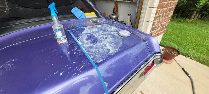

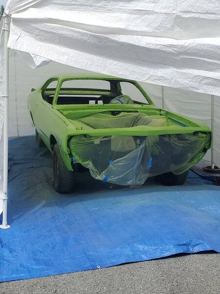

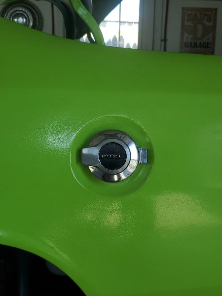

Well, today was shoot Fred day. I am relatively pleased. A light wet sand and buff job and well be right about as good as I'm gonna make it

It looks good Mark! Since it's single stage, how long will you have to wait to do the cut n buff? One of the 'Down the middle' Sport stripes in either black or white would probably look killer on there since there isn't a vinyl top.
:thumbsup:
I gotta read up on recommended cut/buff times.
Yeah, he wants to do a black split Demon stripe down the middle, to help offset the black hood.

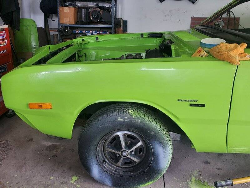

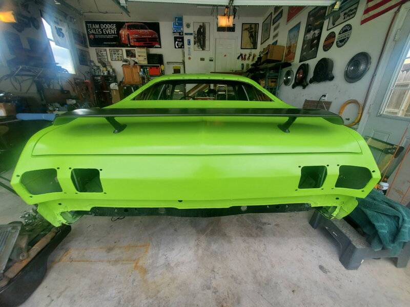

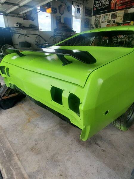

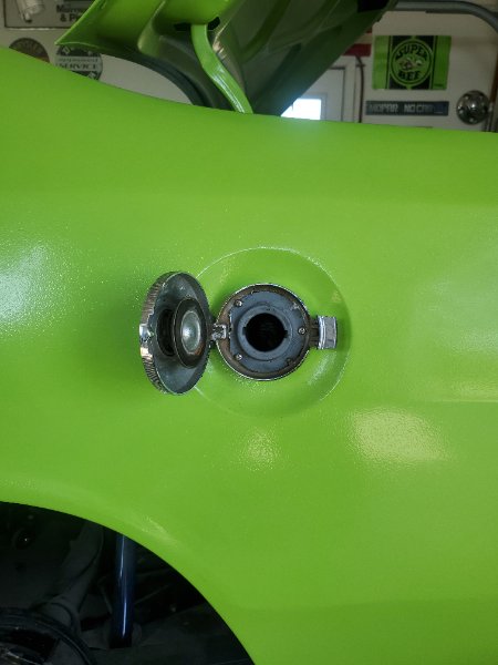

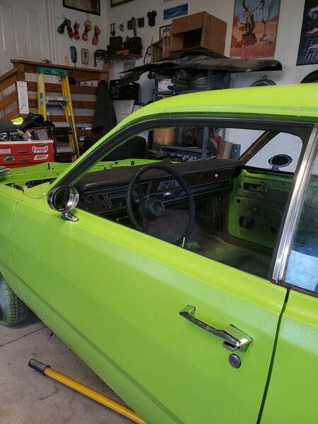

Carved out a little time and got both fenders and the beak done about as good as us rookies are comfortable doing. A little progress is good progress. Piece by piece.

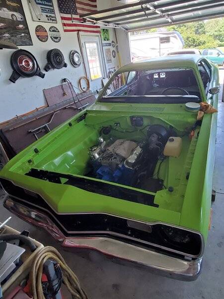

Also got the dash installed and all connected. Wing is on, all weatherstrips are in place, all side glass is in and the door handles and mirrors have been mounted.

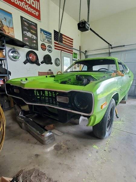

You black grill haters, just shut it - LOLOLOL. The boy is making it his own.

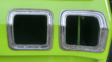

We have a set of better tail light bezels on the way from FLA.

i like the black grill with just that chrome outer edge. the rear lamp bezels would suit that look to imo.
neil.
Our bezels are so bad, we started grinding the pits down and smoothing them with filler. The plan was to black them out. If the new ones coming to us are way better, they may or may not get the blackout treatment. Don't know yet.

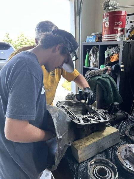

So we tore the $50 core 904 down last night, and got most of it assembled today. Heading to the VFD carnival this afternoon, so we'll finish assembly romorrow. At any rate, for a core trans that had sat on the floor of some rando's garage for 20+ years, not sealed up, this thing was remarkably clean. Looks to have only about 15k miles on its last rebuild. All the clutch disc's had their very pronounced cross hatch look and the remaining fluid was beautiful. Regardless, all new went back in today. Also tore the VB down and installed one of those simple transgo improvement/correction kits. Josh's gf got me a couple of action shots as requested.... Here's Josh elbow deep inserting the input shaft and front clutch pack.
