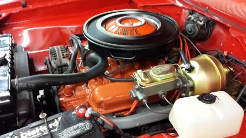

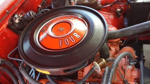

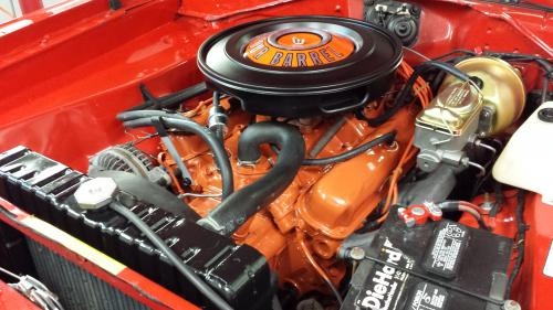

I just detailed the engine compartment on my 1970 Swinger 340 and thought I would post a few pics.
I used a set of Mopar ignition wires that I had for years that were new in the Mopar bag, They are orange in color but they fit a little short...What are others using for stock looking wires?

Your engine compartment looks very nice. I love the OE look!

Im running the taylor cable wires on my 340. They got plenty of length but im trying to remember if they are cut to length or not. Heres the part no. 74071 they are available with three different angle boots at the spark plugs. im runnin the 180 degree boots at the spark plugs and straight at the distributor also come in different colors but im running black ones
'70 wires were black...orange was '72 or later if it matters.
i just bought a set of cut to length parts store black wires with orange spark plug boots

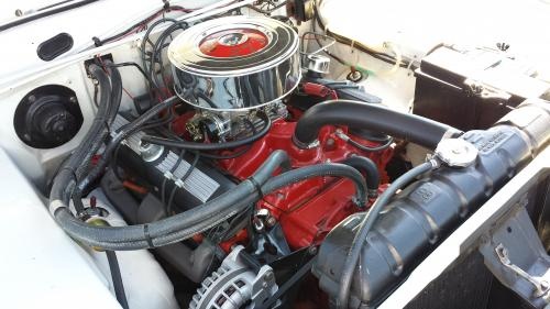

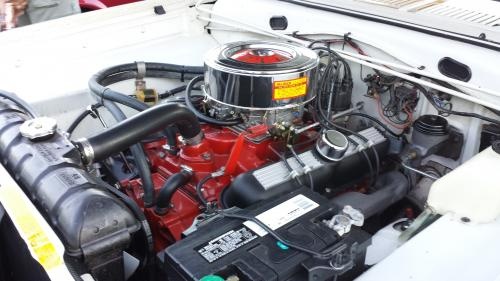

I also have a 1965 Barracuda with a 273....here is an engine detail shot of it.
I did not pull the motor I actually did this detail job in less then 4 hours.
first I cleaned the engine bay with carb cleaner and rags.
then I did mast off the hoses with masking tape as they are 20+ years old
I quickly sanded any areas that needed it.
I put old bath towels down and around the engine and used Mopar engine paint in spray cans (street Hemi orange)
I then polished any bolts with a wire wheel on a grinder
I used a 10+ year old can of exhaust manifold paint made by Eastwood and applied it with foam brushes.
I still will take some time to fine detail certain items as I am retired and enjoy the time I spend on the cars I own.

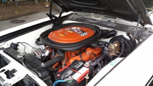

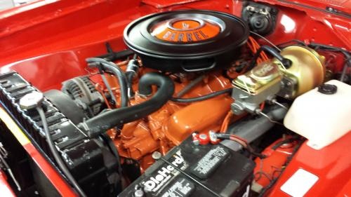

My wife has a 1970 Challenger T/A that she has owned for 21+ years and now tells me she wants to drive it again (she has not driven it in 10 years) she also informed me that her cars engine bay is next in line.....OK Happy wife, Happy life.... Here is a picture of the engine bay in her T/A Challenger............

Engine looks great.
It will be a while before my 340 engine compartment looks that good!

Nicely done! Don't forget a radiator cap and splurge for a Mopar battery. They will really make the difference.

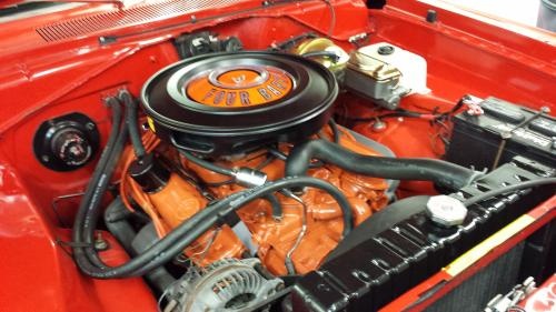

very nice job!!, looks like mine
