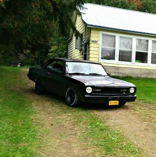

Pic to show progress of my build.
Going to be ditching the true duals, waiting on shipping for my 2.5 X pipe, and dumped 12" Dynomax race bullets.
Car is a punched .60^ 318, comp cam, stock manifolds for now.
Was wondering if anyone has clips or links to their vehicle with a similar setup. Looked on Youtube and there is not much for quality clips.
Thanks,
-Justin
