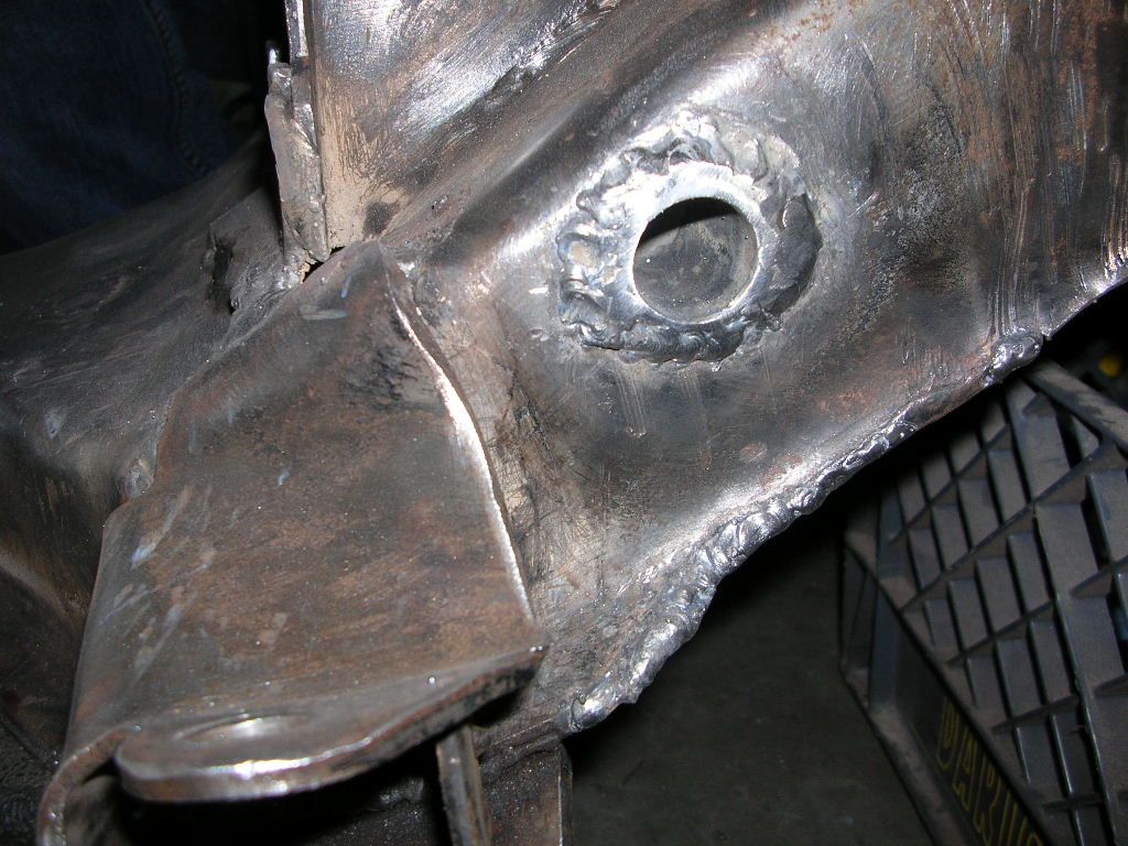

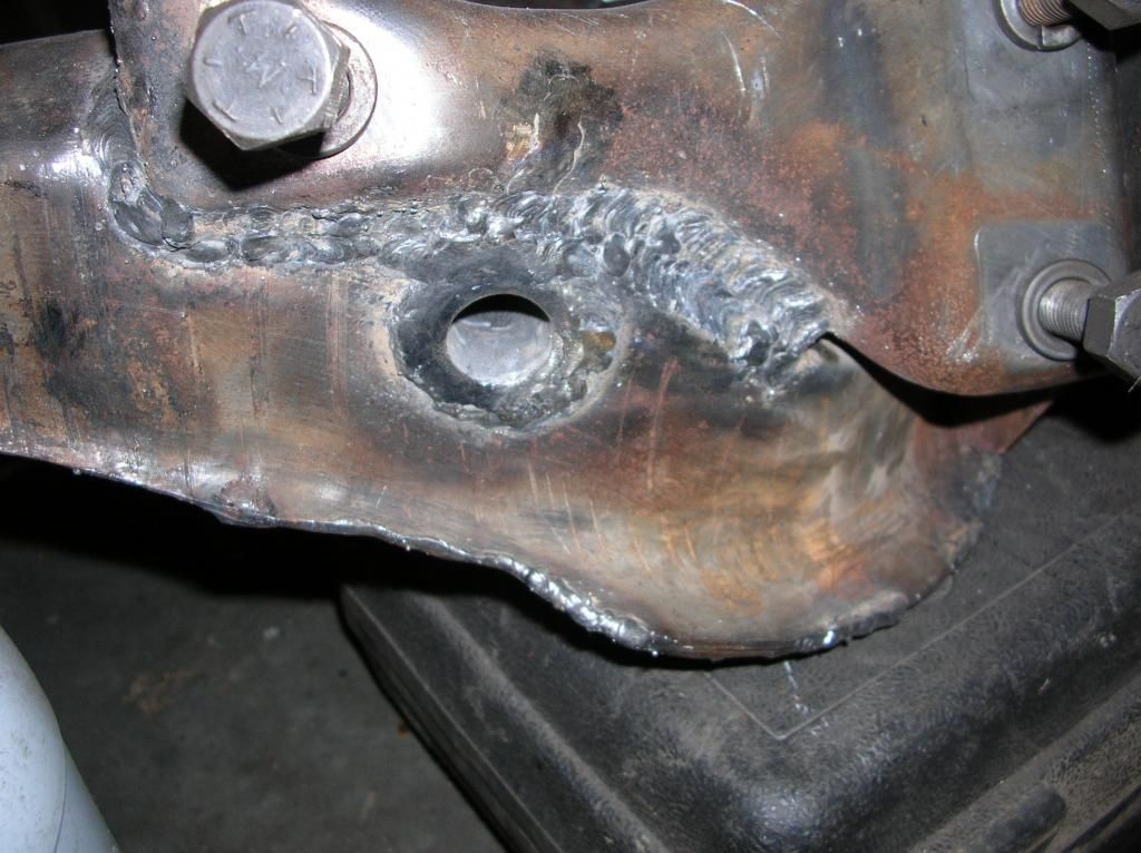

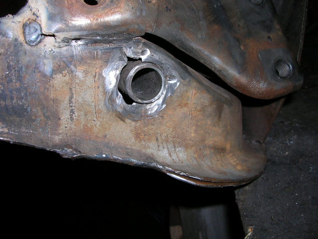

Like this?
You do what I did, all of them eventually fail, it's best to take out the k-frame and reinforce it anyway.
http://www.forabodiesonly.com/mopar/showpost.php?p=1969963421&postcount=62
But if your looking for a quick fix, weld it up, both sides, and do the steering brace like I did while your at it, it's right there.,. See where the crack was next to that first bolt on the left? I'd say this fixes the majority of the flex in the frame.
If you want to go the full way you can touch up the factory welds if you'd like, and go around the perimeter every 2", 1" beads and make that sucker stiff as a hickory bat on opening day.
