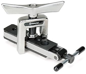

Try to find the type that is a bunch of segments that clamp end to end rather than the more common type that is a pair of parallel bars with all of the holes on the same split-line. Over time the parallel bars bow in the middle and those holes in the middle allow the tube to slip. There is a version of this type, and it may be made by Rigid, where the flaring stirrup has a second threaded clamp designed to stop that spreading. Those may be OK, never used one. I have several sets of the type w/o that second screw, including one labeled "Blue Point", that have spread and are nearly worthless. Trying to straighten them is good for about one flare, and then they're bowed again. I keep them only for the double flaring dies.
...........find the type that is a bunch of segments that clamp end to end .
Imperial makes one of that type, as well. I'm sure there are others
Yeah, like that! My Rigid is pretty similar in every feature except for the flaring handle.
