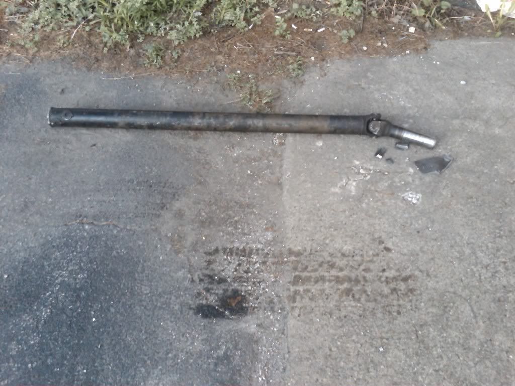

Well i was driving the demon on this great beautiful hot NJ sunday at about 60 miles an hour i locked up... shut the car down and pulled over...my driveshaft sheared off at the rear and blew a hole in the top of the only 3 years old TCI tranny..im so pissed. so anyway i am now looking for a driveshaft and assembly as well as a used 727 semi locally...looks like my cruise season is shot =(. with the economy the way it is and bills it appears this might be the Demons time to get covered for 20 years until i can come up with the money to really get this thing roaring again..

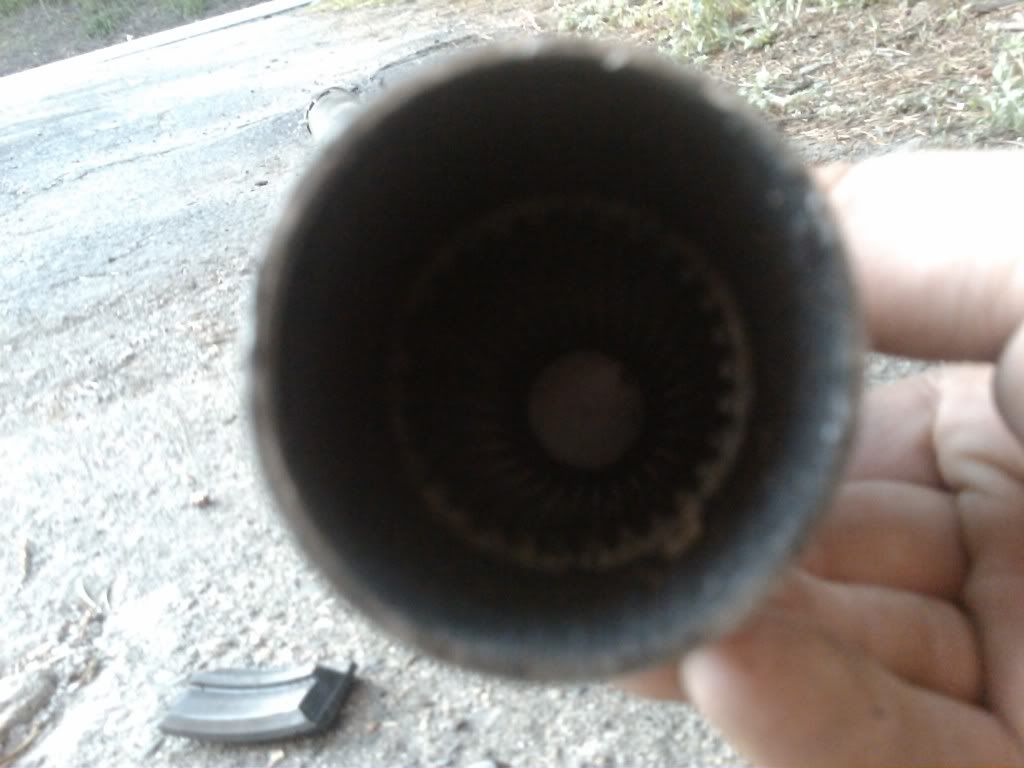

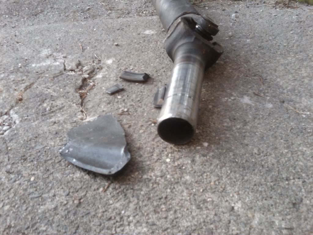

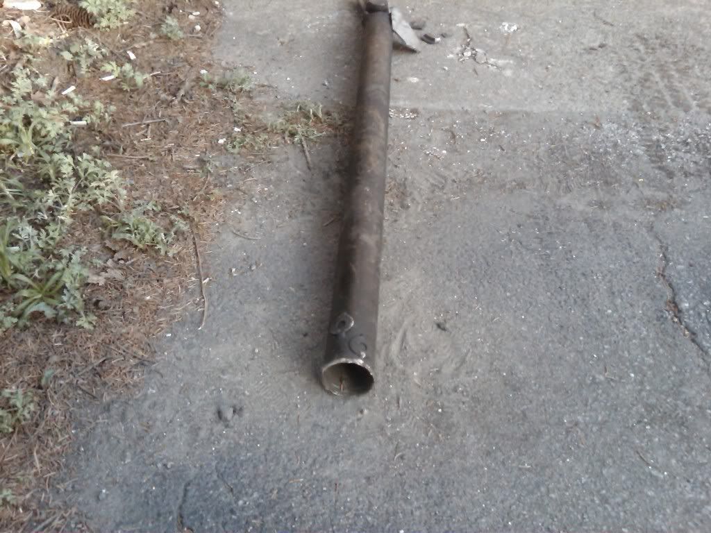

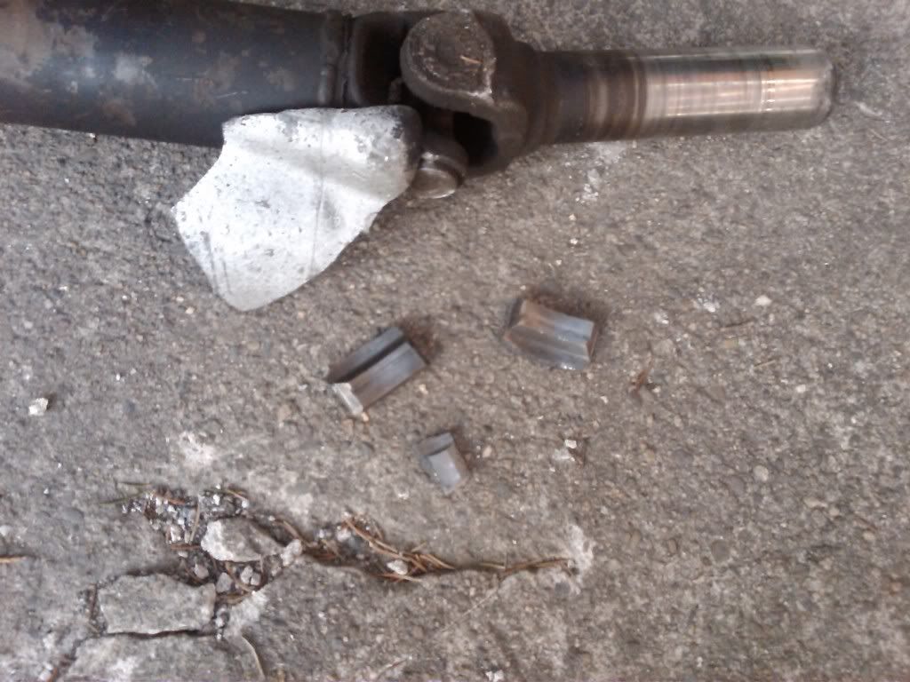

here is some pics of what i picked up off the road

you've got me ..it just went boom ...at this point im happy the motor diddnt blow up too
who balanced your driveshaft?,never seen washer welded on like that before.i'd be interested in knowing that myself.
That could be a factory balance. I have half a dozen driveshafts and a couple are weighted like that.

I'm going to have to guess that the tranny siezed judging by the pieces of clutch basket. If the rear siezed you wouldn't be able to move it off the road, unless a tooth broke off and just seized it for a second but that shouldn't have blown the tranny out like that.

First thing I'd do is jack up the *** end and see if the rear is free turning. The only time I've seen a yoke broke loose from the drive shaft tube was because of a faulty weld job which is what I would guess happened here. Take a good look at the weld at the end of the tube and yoke and see if it's a shiny clean break 360 degrees around or is the break only clean partially and there is also an old rusty line that would indicate an old crack. The tranny damage could be because you oversped her for a split second when the drive shaft came loose. Sorry for your loose.:angry7:
