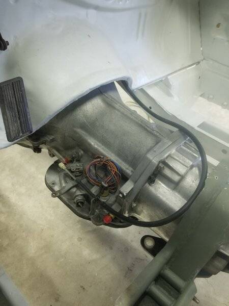

Ran van cable type kickdown lever , and ram van cable holder bracket, along with return spring off a van with a 46RH. 1992 dodge dakota V8 kick down cable. Made carb mounting bracket using a piece off the bracket that mounts the cable on the throttle body end, along with a piece of the old throttle cable bracket and some 1/2" steel angle. I used an edelbrock TH350 bolt on cable end to clip the cable on at the carb end. The eddy 600 has the same throw as the OEM throttle body. All factory parts except for my carb bracket, and edelbrock cable end mount. Heard horror stories of the aftermarket cable kickdowns. This one operates smoothly, and returns nicely. Has a push button adjustment at the carb end. Cable is OEM. Matter of fact, I bought a new NOS mopar brand dakota cable to use. Cost $45 for the new cable. Kept the used mockup cable as a spare if ever needed. Other than the new cable, and edelbrock cable stud for the carb end, I got maybe $20 in used parts from the junkyard and a few hours invested in it.

On the trans end of things I went to the junkyard and bought levers, return springs, return spring brackets, cables and cable supports out of a V8 ram van and V8 dakota, and mixed n matched the stock stuff. Figured out the all the ram van junque worked perfectly with the shorter dakota cable to clear my trans crossmember. Van cable was an extra foot long woulda been a problem. $20 or so for all of it was worth having to figure it out. Cable pulls and returns smoothly. Nothing binds up. Sometimes stock stuff works the best.
