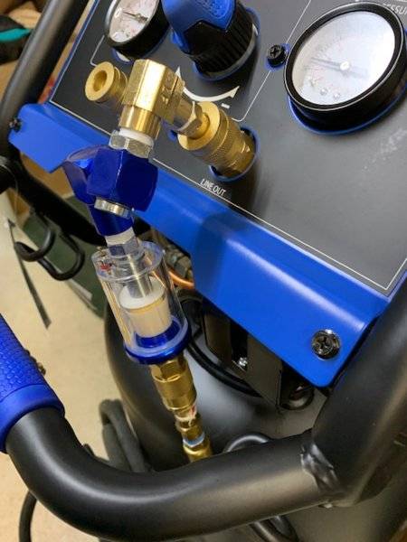

Just picked up this Kobalt 26G Oil-free(ish) compressor because it's quiet. Yes it is however, after the lengthy fill-up, it spits moisture from the first use. My older, extremely LOUD HF compressor has a simple moisture trap I added. If possible, can a trap be added to this type compressor? thanx ahead.

Yes, you can and should put a moisture trap/line filter on those, but those only protect your discharge lines. Even more important is the drain plug on the bottom of the tank! Airborne moisture/condensation builds up in these tanks VERY quickly (especially this time of year) and can rot out your tank fairly quickly if you don't drain them often. I've seen new tanks come with just a pipe plug in them; pull that out and put a decent valve on there and use it regularly (I do it every week or two) to keep your tank dry. You'd be shocked to see how much water comes out of there!
Air is heated when it is compressed, and that hot/warm air carries moisture from the atmosphere. If the water trap is not far enough away from the compressor for the air to cool off prior to reaching it, much of the moisture will pass right past the water trap.
I found a good article about this on the internet years ago. It recommended running at least 50 feet of line slowly ascending up the wall and then down to a down pipe with an upward trending dogleg pipe with a water trap. Then on each end of the 50' of pipe run a vertical pipe with a ball valve on it to drain the water from each end.
I used galvanized 1" pipe for my line that zig-zags up the wall, and not even one drop of moisture has ever come out of my water trap. Lots of moisture will drain from the 2 ball valves though.
