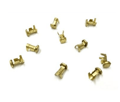

I have a project where I need to crimp on the little brass terminal in lamp holders.
I bought some from one of the eBay or online venders but was having a time trying to get a proper crimp. So I went looking for a different seller that might have a different part. I tried several search terms and kept coming back to the same sellers.
American Autowave and another I don't recall, then the eBay sellers.
I looked on Newark electric, they had to have them, couldn't find anything, so I chatted with their technical folks and guess what they are called...
Wait for it....
"Fuse Brass Terminal"
google that term.
There are a lot of other unrelated things that come up but there are several sources and even some different sizes and for different AWG wire
The one in blue from Aliexpress looks really promising. It comes with a 5mm or 6mm head and they appear longer than the others which makes crimping much easier.
I just found the same AliExpress on Amazon Search "Automotive Brass Wiring Harness Connector Crimp Terminal Fuse Holder"
I bought some and will report back on how the work out
UPDATE
American Autowire got back to me on their brass terminal. Their terminal does not have a crimp for the insulation, that's why their crimpers will work so well on their terminal.
Here is the offering from TE (Tyco)
Side Note:
The barrel connectors (trailer connectors) are called "SHUR-PLUG 180"
60660-1 : SHUR-PLUG 180 Crimp Wire Pins, Tabs & Ferrules
