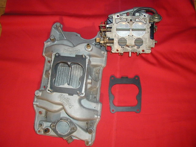

I did the MoPar mod's to the LD-340. I also have both intakes and working on a 360 to test and have fun with them.
http://www.forabodiesonly.com/mopar/attachment.php?attachmentid=10166&d=1173218221
This thread; http://www.forabodiesonly.com/mopar/showthread.php?t=24073
If you have an LD340 now I wouldnt spend the extra for the little gain.
Hey Adam, I went thread hunting and you photo's of your LD-340 are no longer there.
