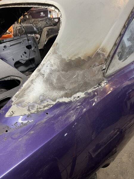

I used it to fill a couple long partial quarter panel seams. One panel was stepped, the other fit into it and was welded but the fit up wasn't as tight as I like, which is to have the weld fill the gap. So I felt this long thin line would probably show through regular filler. It worked good but sure is a lot more work than using fiberglass reinforced filler. I ditto the comment on the Gene Winfield video...could not have done it without that instructional lesson.

If you do some leading send Pics. You may want to fab up some wooden paddles that will fit your needs.
