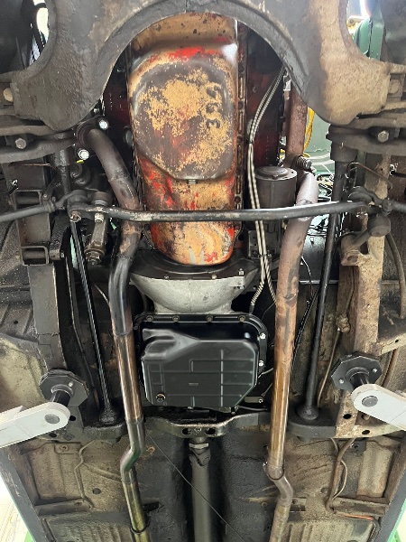

Thanks a LOT you guys for the great photos. After the explanation about the steering box, I did not know what to expect. Looks like the center link is pretty much in the same place, just the idler/ pitman trail behind it
The real headache was when V8s were fitted, especially the big blocks, in A bodies. The same LHD body pan & K member was used, biased towards the right side; very obvious in top pic of post #4.
Makes it really tight for the exh system on the rt. side with a BB engine, steering box, etc, on A bodies. Only SB engines were sold in A bodies. Polys came in B bodies up to 1966; in 67 & later SB or 383 was optional.

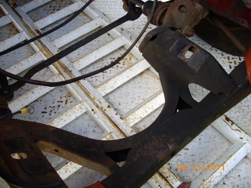

Sorry I haven’t got any helpful photos, that’s my green barracuda on the thread you linked. But I do know that there are issues associated with the steering box flexing the frame rail where it is attached, leading to corrosion and failure the previous owner of my car had plated up the frame in that area to reinforce it.

I can attest to that! A mouse made a really nice nest in the RH frame rail of Bazza's VG, right where the steering box attaches to the frame, and the resultant moisture caused enough rust that I had to cut things open and fish-plate a repair. Not a fun job, by any means.

So from what I can work out they only imported a few hundred and sadly by now there are not many left. They came with stiffer torsion bars, front disks, anti roll bar and a Sure Grip 8.75. It is such a nice car for here because it’s an A body it’s not even that big for our crappy little roads. I’m taking it back with me to Australia.
Wow...you can see the added structural brackets for the steering box mounts. Also, look close and you can see a fairly complicated transmission shifter linkage that seems to run to the LEFT side of the car for support.
It’s one of those details where it’s really surprising they didn’t work out a better solution.
Agreed! When I dropped the k-member I couldn't help but think they (Chrysler in Oz) just grabbed something off the shelf instead of engineering something a little more "proper".
