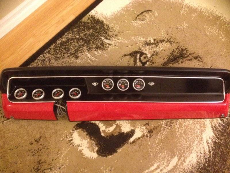

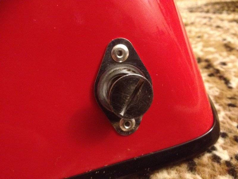

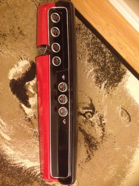

I just finished up a vfn fiberglass dash. I am told it's worth 35 pounds over stock.
