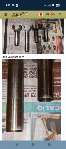

Noticed a slight lip/ridge when I took ds out. Normal ?
67 barracuda 904 trans.

Yes normal. Not wear.
There are long yokes and short yokes.
These yokes have the same length splined area just the longer one has additional material past the splines. They are NOT intended as a yoke that can protrude out of the transmission farther
The one you have is the long, functionally the same as the short.
BUT... I read somewhere that they changed to the shorter one due to vibrations introduced by the long.
If you put a short next to a long the seal surface from the yoke to the end of the seal surface is the same on both.
Post 4
904 slip yoke
Far left is aftermarket
Next it long
Next 2 are OEM short
Btw, I inserted the long one I have all the way in (without a seal installed) and it never bottomed out on anything internally.
My dart was built in Feb of 67, and has the shorter yoke. (@4spdragtop) Steve when was your cuda built?
That is a poor design in my opinion.
Not really. The smaller OD goes into the seal and then as you push it in farther the seal expands easily over the seal surface area.

The stepped area on the pictured A904 slip yoke is normal as originally machined. The inner splines end in the same area. The smooth bore portion is for the slip yoke's inner seal used in 1966 A904 transmissions, and 1965 - 1966 A727 transmissions, except Imperial.
The inner seal was dropped for 1967 and later, but the yoke extended smooth portion was retained until 1970. The following image shows the inner seal:
The inner seal was placed on the output shaft ahead of the splines in a machined area for it. The following image shows the seal on an output shaft:
The following diagram shows the seal as installed in the 1966 transmission:

I have only (up to now) seen the shorter version other than the one I bought. My 67 is a one family (my dad ordered it) it has always had the shorter version. My assumption was the longer one was phased out as parts ran out.
But your info was really cool to see.
Thanks
Thanks
It was likely a phased change in machining, and supply, until the formal part and numbering change in 1970.
