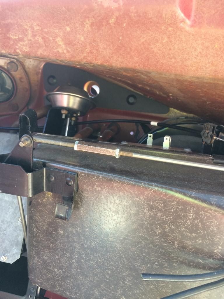

Hello,
Can anyone provide a photo of where this piece of insulation goes? I removed it from a 71 Demon with A/C a few years ago, and can't figure out where to install it in my donor vehicle.
Thanks in advance,
Michael
From what I can tell from the pics maybe above the master cylinder
Thanks for checking.
I'm pretty sure it came from the passenger side; I don't recall removing anything from near the master cylinder. Can you post or send any photos?
Thanks again,
Michael
I'm headed home from my drilling rig I will look closer when I get there...that's the only place I seea single hole in the firewall
well i looked and from what i can tell it looks like it might be the one behind the pas side heater floor vent...the door that opens and closes...right behind that
it goes up high on the firewall, almost center but above the HVAC box. The 2 small holes are where you would push the securing pins thru to holes in the firewall. I know its been a month but if you need a photo...
