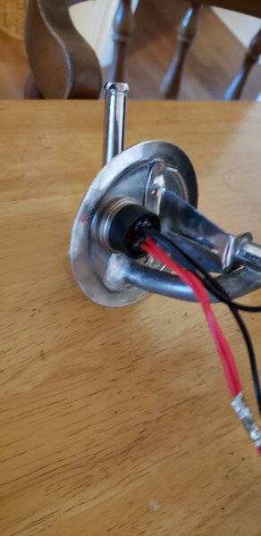

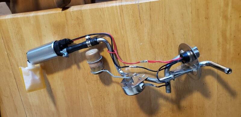

I silver soldered a 3/8's" return fitting onto my replacement unit that had a 1/4" return nipple.
How did you do that without cooking the wire entry?

I had the unit out of the car, used a step drill to carefully enlarge the 1/4" return hole ( used small micro torch to heat and remove original 1/4" fitting) until my 3/8 steel tube fit tightly and used 2 small pairs of vice grip plyers to act as heat sinks while I silver soldered the tube in place. The wired bulkhead was added after the tube was soldered in place. I sourced that from Radium Engineering, but there are other sources too.
