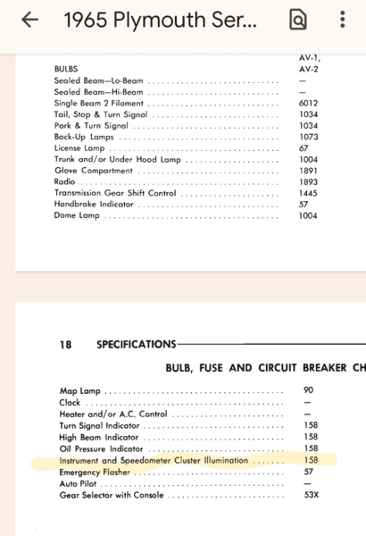

My cluster panel lights have not been working. Bought the car over a year ago, and other owners obviously did all sorts of work. Fuses are all in order. I pulled the cluster yesterday and took out the bulbs. 5 out of 6 were 194. One was a 158.
Did the prior owners put in an incompatible bulb? Or would a 194 work? I’m looking to replace all the bulbs with LED versions but want to make sure I’m getting the right ones since LED ones are so expensive.

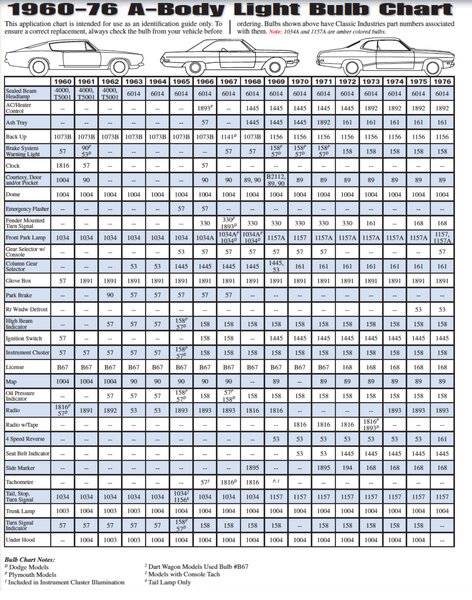

I found this chart online this morning, but want to be sure.

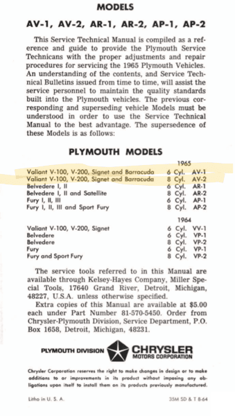

Download your cars FSM
Page 727 /728

The '65 I owned, and I'm pretty sure all the '65s I took apart over the years, used the metal bayonet-base bulbs (53, 53x, 57, 1891, 1893, 1895…) in the dashboard. '66s definitely used the all-glass wedge-base bulbs (158, then in later years 194).
