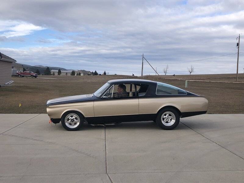

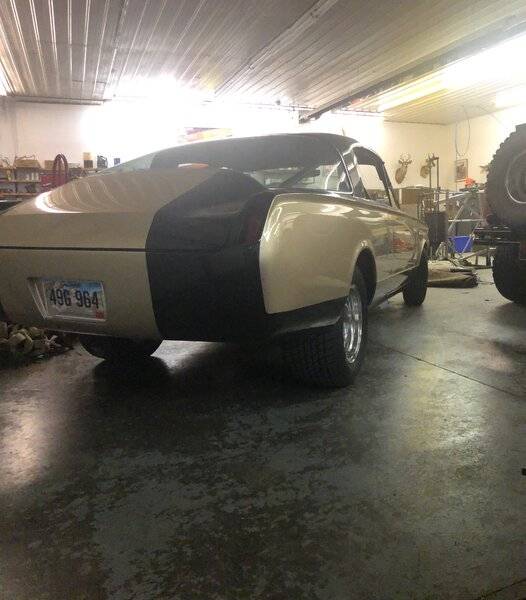

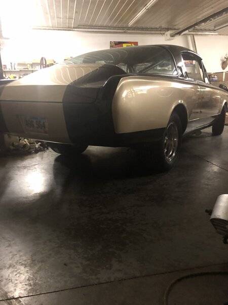

looking at the background of your picts I’ll assume you’ll be doing some 1/8th mile drag racing.
The closest track is 1/8 mile. I wouldn't mind running the 1/4 mile but the reality is, that track is several hours away.
Well I put the SoDak plate along with the picts and assumed Sturgis Dragway would be your “close” track. We bought land about 25 min from there east of Piedmont. We hope to live up that way in about 3 years :)
It's a great area. Lots of people moving in from all over, for better or worse!
