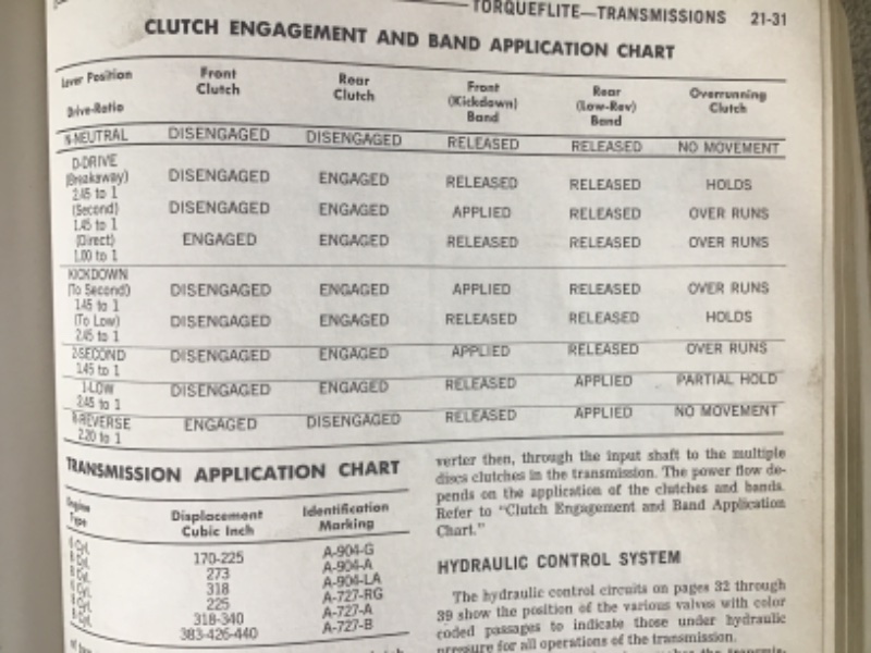

Does anyone on here know what to modify to make a non band apply into a band apply? Anyone have pics of them side by side?
I ask, because there are a lot of smart folks on the forum.
727 get a LBA valve body
904, meh... either is fine.
Please explain this, they both have the same things going on inside. The high gear drum will still go 3X RPM upon failure of sprag
Size of the drum and critical mass RPM diffences between them. I don't believe it's 3x, it was the first gear ratio in trans.
727 critical mass is around 12K which just about any good running BB can hit. Only about 5000 rpm
904 critical mass is around 23K rpm IIRC. Gotta spin that engine up to some real RPM to hit it. Most street strip stuff never gets there.
My 904 doesn't have low band apply. Just got to watch it when coasting and then giving it gas.
