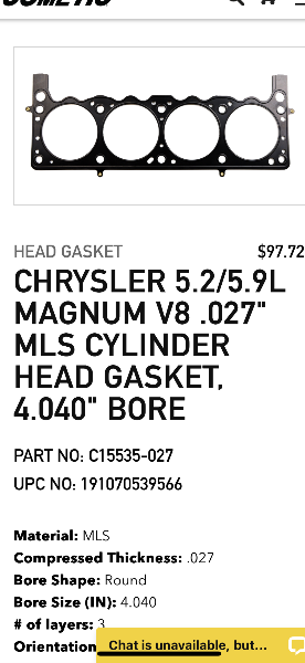

You’re correct, you can use them interchangeably. As long as the deck height doesn’t cause issues you’re good to go. In fact, because the magnums use the same cylinder head regardless of displacement, most manufacturers list them as 5.2/5.9 head gaskets. I use the cometics below on my 5.9.
Excellent, thanks so much for the reply. I will use the head gasket according to what the machine shop tells me my overbore will be. MUCH APPRECIATED!
