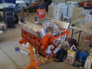

Does anyone know where to find valve cover spacers for Magnum Heads? I have a Jomar stud girdle on mine, so stock covers aren't even close to fitting. I've heard of making them from wood, but not too sure about that.

I need about 3/4". If i take the baffles out, I can get a little, but even with doubled up gaskets, it won't be enough. The locks for the girdle are a lot taller than regular locks.

I have a nice set of Aluminum Fab Covers with Cometic Gaskets and Allen Bolts that will clear the Jomar Girdles. I will sell them to you if you want them.
$200.00 plus shipping. Baffles are installed in them already. They are WAY nicer than the CHEAP Pro Comp ones!!
They have NEVER been ran just used for Mock up!
