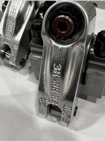

So during my morning shower I thought about this a little more. Some of you guys act like chevies and fords have zero issues. Well if you would get to the tracks more often you would found out exactly how it is. I’m not talking about a few of our 11 second Mopars that use hose clamps on their transmission lines still and are know to cause a three hours cleanup twice a year but I’m talking 4-5 and 6 second 1/8 mile cars. And at keystone we have a lot of them. I honestly can’t think of one major engine failure last year but boy my Chevy friends sure put on a show. They broke and broke often and I’m not talking Speedmaster and Edelbrock parts they broke good parts, expensive parts. It’s gotten to a point where APD a carb company stepped up and started offering rocker arms became they can’t last the season with the expensive ones out there. So get off the couch and open your damn eyes, please.

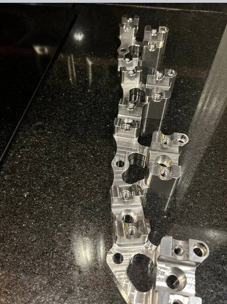

One of the cool things he does is the min cap registers aren’t just outside the center main bolts like an OE block, or the X and the R blocks I’ve seen.
On his 4 bolt caps the register is on the outside edge of the cap.
That means if you have to cut the cap to fix the main bores you don’t have to deal with the step.
