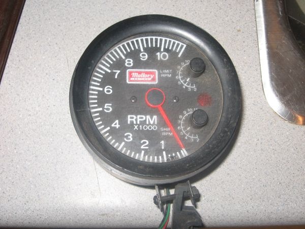

mallory 11k tach hook up problems help please !
I have a mallory 11K tach with shift lite and rev. limiter .. has 4 wires on it to hook up.
Green coil neg.
red 12v source ,
black ground
white lite.
hooked it all up to these instructions and when I hook the green coil wire up it will kill the engine..
I am running a oem mopar dual point dist.
what do you think the problem might be ? maybe needs a tach adapter ?
or just won't work with a points dist.?
Thanks for any help.
if it wont work, then its broke. green= neg side of the coil, red=power, black=ground , just for kicks , un hook the white wire, and hook the green wire to the + side of the coil.
Maybe this can help shed some light.
anyone make anything out of what mallory says here how to hook up?
sorry .. my error >>>>
black is ground and
white is for light
.. white is not a ground .
black is ground and
white is for light
the reason i suggested switching the green to the positive, is because when i bought my duster and decided to add a tach, it did not work, but it worked fine in my charger, so i put it back in the duster and hooked the green on the + side of the coil, and of course it worked because the PO had the coil wired backwards. i also just ran the light wire together with the hot.
If it kills the engine, either the tach is bad, the green wire is shorted to ground, or it's a special order positive ground tach.
Have you been inside? Are there any configuration switches/ jumpers?
Did you buy it new?
It is a used tach . do not know history on it .......
Yes tony ........ I took the cover off and looked inside and there was a switvh for 4,6 or v-8 engines . It was on the 8 number for v-8.
All the wires were intach , nothing cut or pinched.
don't know if it was a tach for a pos. ground.
I hooked it up to my other dart with a msd unit and a electronic dist. the needle would idle right for a few seconds then start climbing without even reving the engine..
then the next time I touch the red wire to the battery pos is sparked all over. think it is shorted out inside..
I think the tach is junk..
oh well ...... I tried.
I think you have two threads going? If you'd like to pay shipping, I'd be happy to take a look at it for you.
something fried out in the inside ... It filled the clear glass up with smoke when I was testing it .. the insides smell like smoke bad .. something burned up ,, when I had the cover off and looked inside I did see one wire attached to the circuit board that was black and sooty.. that must be where something melted down.
major Junk now !
