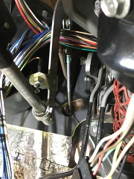

@DionR can your brother send some pictures? I am having a hard time visualizing any interference. The master is attached behind the clutch pedal on the malwood, I just can't see where the pull park.brake would hit?

I can ask. I do have this, but not sure how helpful it is.
I believe it was. Does that make a difference?

Ross states only 2 inches on left side of brake/clutch pedal bracket are needed for the kit. Viewing this photo I just found on another post, I can't see how It is an issue.

Here's some pictures from my car. No extra holes for a different e-brake location.
Looks tight, not saying it won't work, but doesn't look like a lot of room either.

I just installed mine on the weekend and can confirm there is no interference. I drilled a hole through the oblong body plug which I think is for a factory clutch rod for the pressure hose, lines up perfectly with the master feed fitting.
