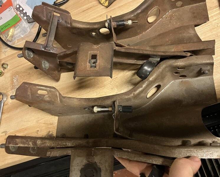

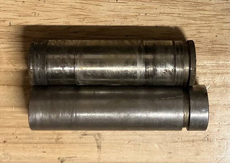

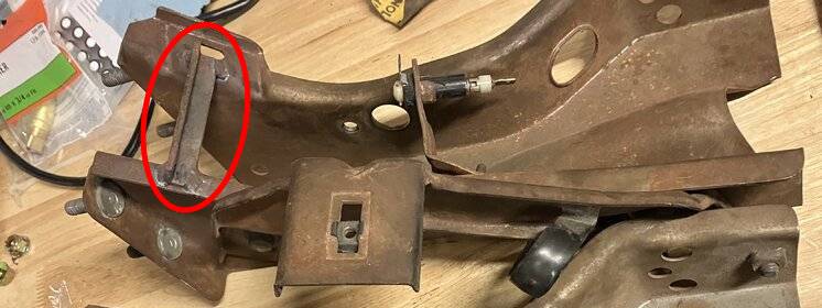

I have two 1968 Barracuda pedal frame assemblies. One for an automatic, one from a 4 speed car. Only difference is the 4 speed car had a brace across the front. Mine was broken and I had a professional welder friend repair mine.

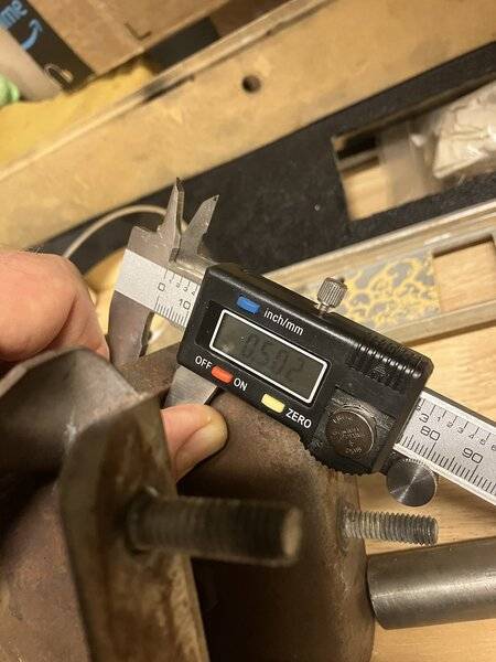

Other difference I found was the pivot shaft for the brake pedal was longer on the 4 speed. More later on how that could matter. The groove on right is what locates it in the frame. So the bottom one would stick out more on the side the clutch pedal assembly attaches to.

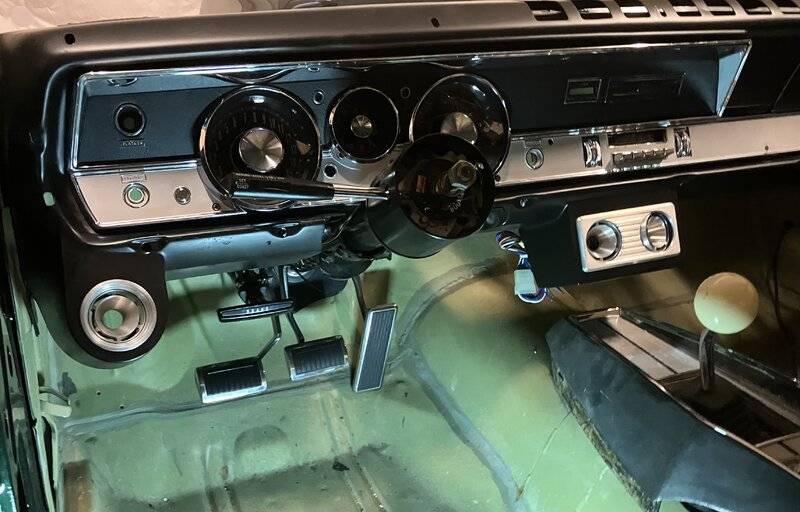

Here is a factory four speed pedal assembly:

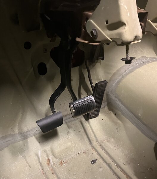

Here is the older version of the Malwood kit installed on my car. Pedals came out very close together. I did a facetime phone call with Ross at Malwood and we could not figure out how or why mine was different.

And a youtube video showing the park brake clearance issue. The clevis rubs on the corner of the assembly and the lever sometimes catches on the bolt head for the clutch pedal pivot. If you were to install this with the longer style pivot shaft it would not clear at all.

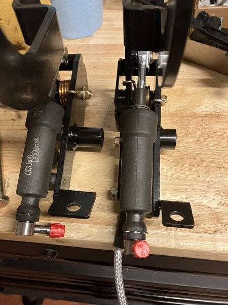

Ross made a change to the pedal location and sent me the new version of the kit. He had already made a design change to help with the park brake lever clearance issue. He moved the assembly up closer to the firewall and that allowed it to be closer to the pedal frame.
Here is the old version in the left vs the new version on the right:

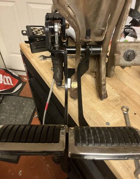

Here is the new version installed in the pedal frame on the bench:

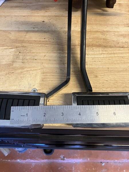

Pedals are 5-1/2” center to center and with the stainless trim there is about 1-5/8” space:
Here is the new version installed in the car:

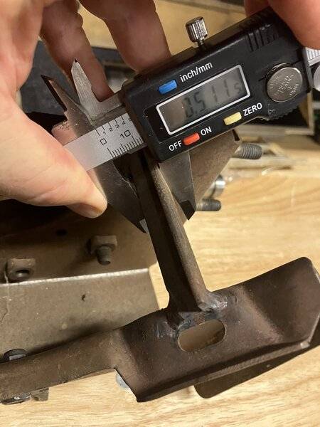

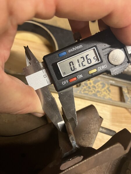

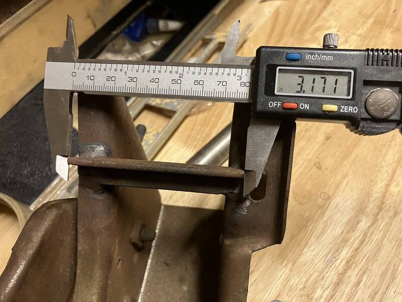

@mosleyme Since you have that pedal support out, can you help me with the dimensions of that piece of angle steel? I'm looking for the thickness of the steel, and the whether it's 1/2", 3/4" or 1" angle steel. I need to weld in that piece to strengthen my pedal support.
Thank you very much!
1/2” angle, 1/8” thick, 3-1/8” long.
and, because my 4 speed brake pivot is longer I’m adding this for reference
here is auto and 4 speed side by side
