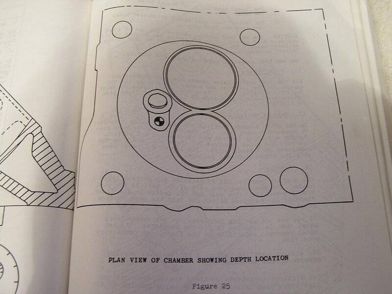

Don't know if this will help, I think(?) it's from one of my old DC books. Now it's just another picture on my computer...
