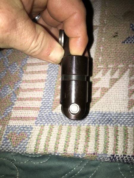

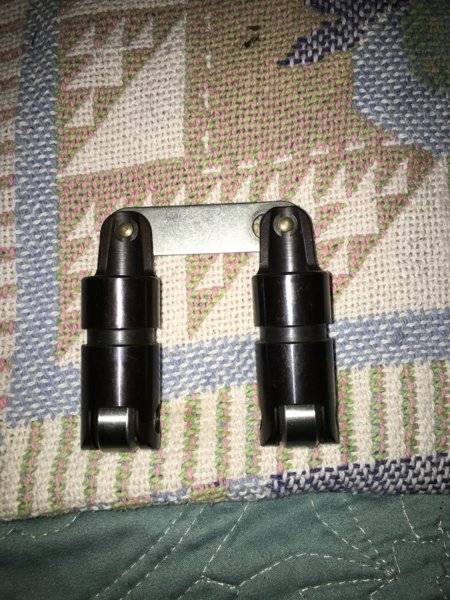

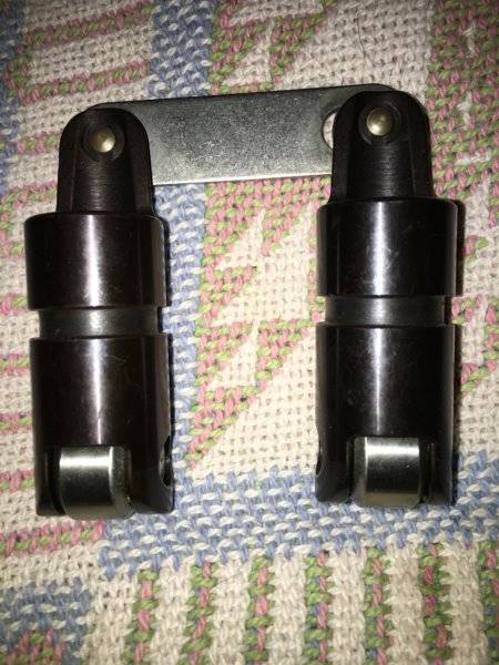

Anyone able to ID these bb Mopar mech roller lifters . Brand new in box but no manufacturer or part #. .750 roller size !! I notice there is no oil feed hole either . The old guy I got them from said he bought them for his 440 . Never used them. He had a computer invoice for them . The invoice was really faded couldn’t tell anything about place bought or part #.
That looks like a Herbert lifter. I don't know where Herbert got his lifters from, so they could be the same lifter in a different box.
That would be the perfect lifter for a nice hydraulic roller lobe. Set the lash at .0015-.0020 cold and run it.

Is the hydraulic roller lobe ramp not as aggressive as to a mech roller lobe ??
Looks just like the Herbert lifters I had in the 90’s.
I used them with a .650 Ultra Dyne roller for 3 seasons of bracket racing(no street use).
I’d be okay with using them on a milder lobe on the street...... I just wouldn’t leave them in for too many miles.

Thank you Sir !! Very good to know !!
