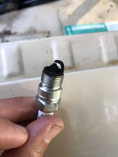

I took out the original spark plug and it’s black. New plug in and she’s running fine. Purring real nice.
So now I need to figure why I’m running so rich on cylinder one, enough to be fouling a plug.
Here’s a picture of # 1 plug. The other five look great. It’s gapped at .035
Check the plug's resistance. Non-res should be close to zero, res plug should be 3000-7000 ohms.
Couldda been a bad plug. Hairline crack in it.....bad wire.....check the cap, too. Run a compression test. If #1 is low, then it's not burning all the fuel it should.

Well, the spark plug is new and the wire set I bought brought eight so I put a new wire on there as well. New cap and rotor too.
Car ran good for about 10 miles and new it’s missing and fouling up again, plus black soot out exhaust.
