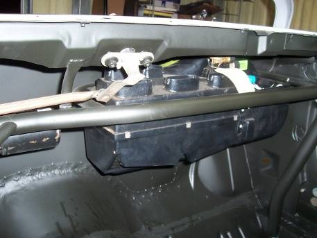

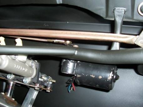

Mounted a wiper motor under the dash to clean up the engine compartment. It is from a Ford Ranger, not too high tech. It's got 2 speeds and is really compact.
