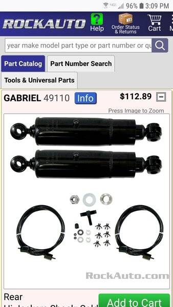

Here you go, air bags in a can.
Gabriel Hijackers
'72 Duster at Rockauto

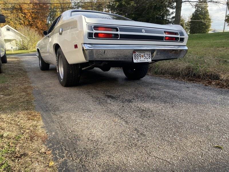

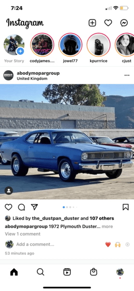

Your leafsprings aren't relocated? What's the aspect ratio on that rear tire, again? I still think this car has the perfect stance.
I've said it several times . Depends on what car . The dart with 255 70 15 runs against frame and trunk well , the duster rubs on quarter panel when my shocks leak down .
It's all about fashion over function . My 198 slant isn't going to the track lol

275 60 15 looks damn good on a Duster. I went with the 295/50s. Springs haven't been moved in but they are super stock Springs so I don't have any problems with that thankfully car had 225 60s on the back but every time you mat the gas the car'd try to turn all the way around on you, at the very least go sideways. That's with a 2200 stall. Now I need more stall LOL

Been using Gabriel Highjackers since 1974, not to prop up springs that won't hold the car where I want it, but to keep the car at the correct stance when it has a big load. Never had the problems that you describe. What I don't get is why the car doesn't rise until you put 80 psi in the system. It should move the car with 25 or 30 psi.

HiJackers must work differently. The range is 25psi to 135. I've never owned a set of Monroe Maxs but I can't understand why there would be an 80psi min operating pressure!!!

When they leak down you can see why tire hit quarter on bumps in the rd . And can see where I'd like to have them . Not all that high
