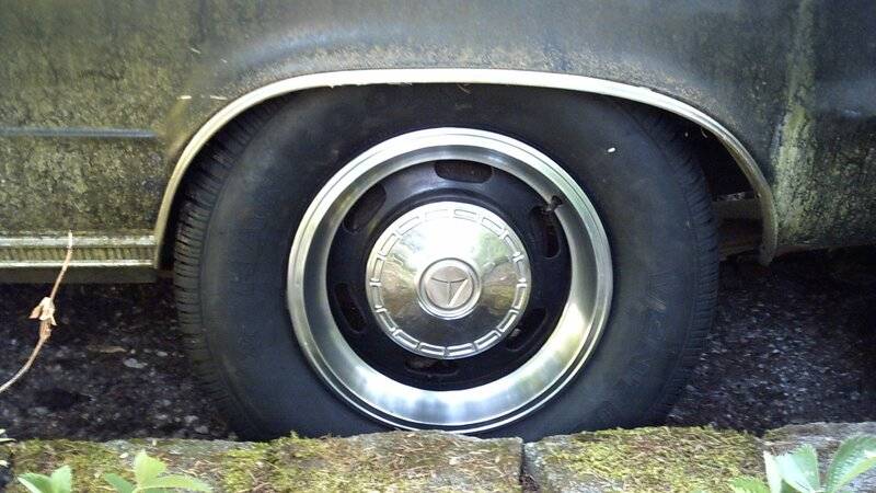

View attachment 1716058257It
It doesn't matter what tire I have . Get over it . My shocks leak down that's the problem . That's all I'm trying to ask about if A tone else has this problem and or what air shocks suggested . I've gotten all that . I don't need input on my tire choice. 275 for life
