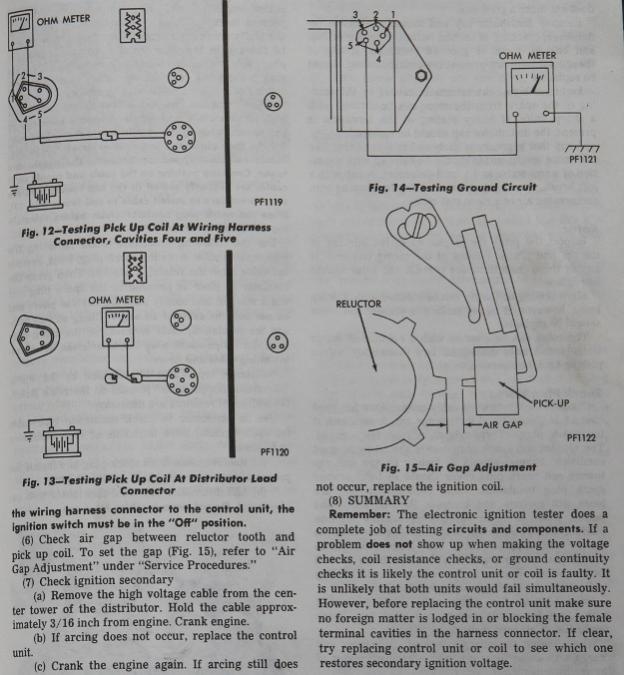

Here's some info I hope some of you can use, out of the 74 shop manual.
CAVEAT: This MAY and probably DOES only apply to the older 5 pin ECU, and not to 4 pin and or third party brands which may be different.

on the other hand i'm lucky enough to have one of these...
great info. i never could understand why they just didnt put in .008 right there with the "air gap" in the diagram. this along with your other half dozen electrical trouble-shooting posts should be sticky. ive tried to get them there but i have gotten no cooperation
I just measured the resistance of four pick up coils, and found the resistances span from 295 to 300 Ohms. My meter is in calibration, with resolution to 0.1 Ohm. I wonder if early pick-ups had a higher resistance of 350-500 ohms.
I don't think that resistance is at all critical.
