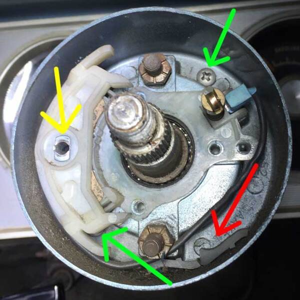

Here's a pic of the spring loaded horn button contact .
If you touch the wire off the steering shaft, the horn will sound.

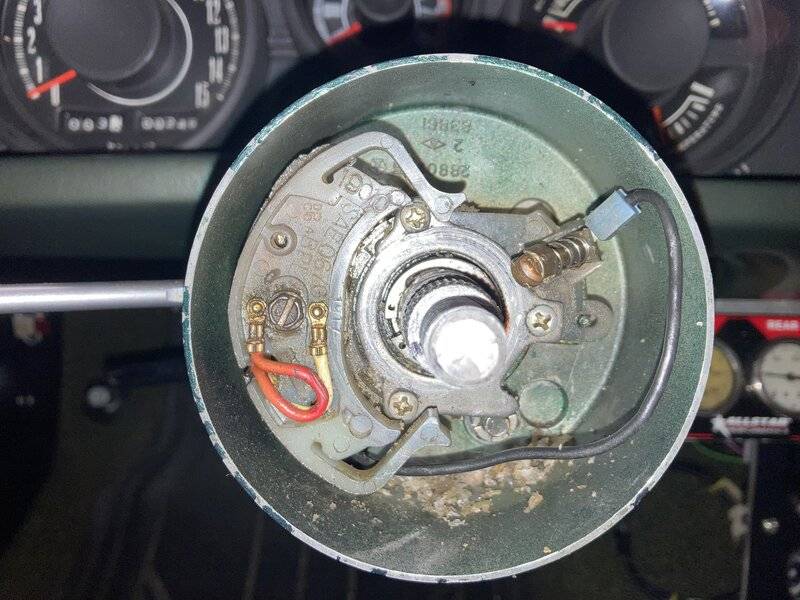

Got into the horn issue this evening, found the spring loaded horn contact roller very much out of position.
IIRC the spring loaded roller was encased in a flexable clear plastic housing, what was left of that was at the bottom of the
steering column in pieces.

Cool!
Looks like that was your problem!
