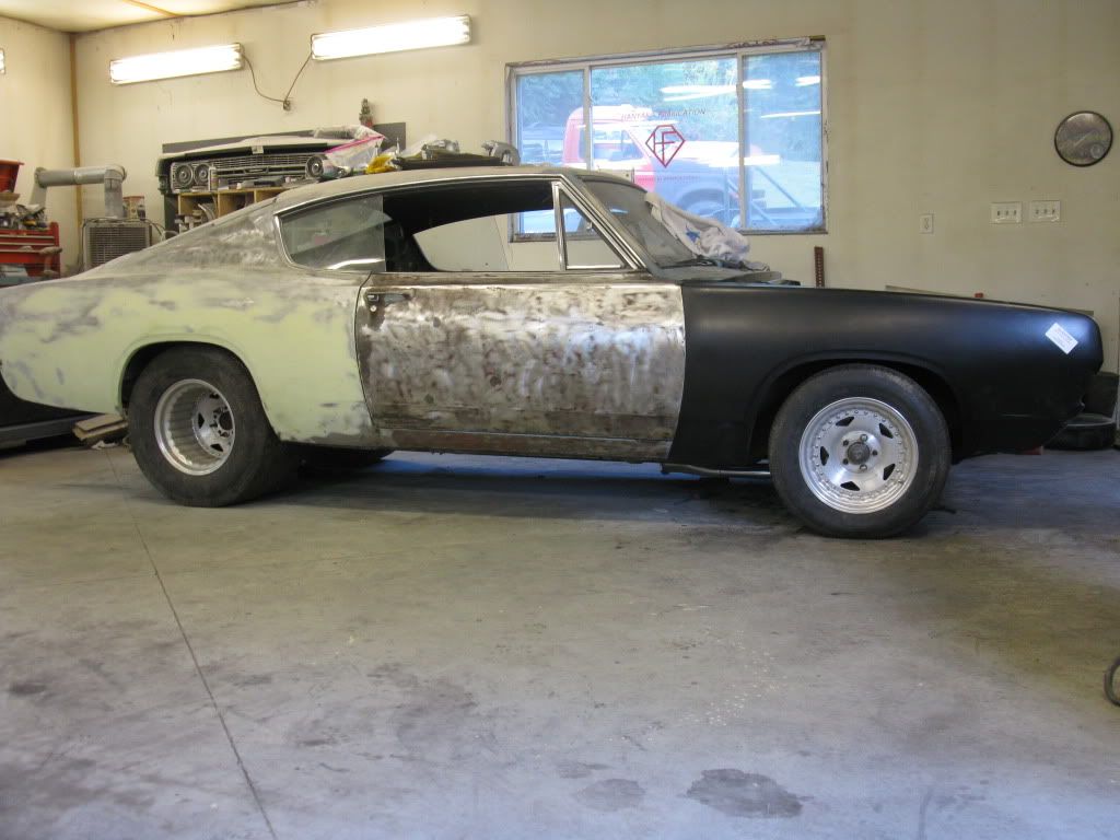

Back in again, (hopefully for a while). Still some touch ups to do.
The inexpensive E-bay radiator, and my new Glasstek fenders set in place.

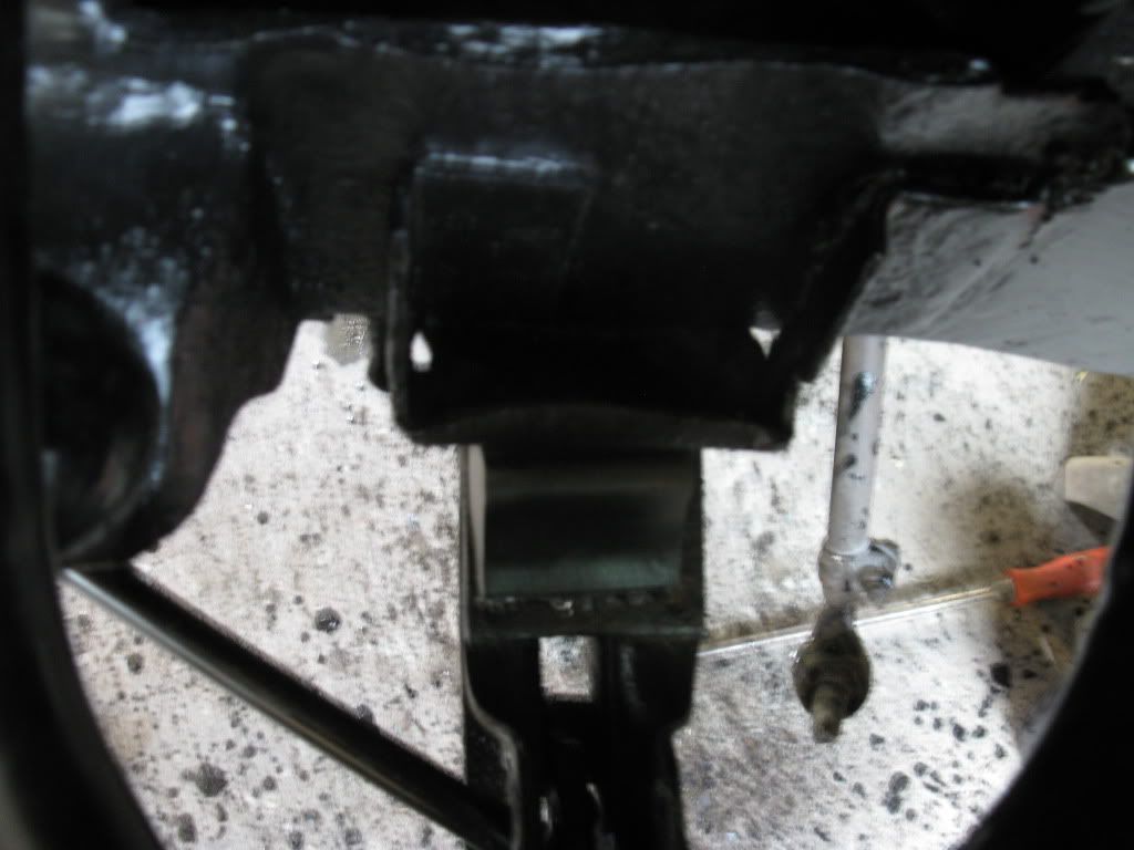

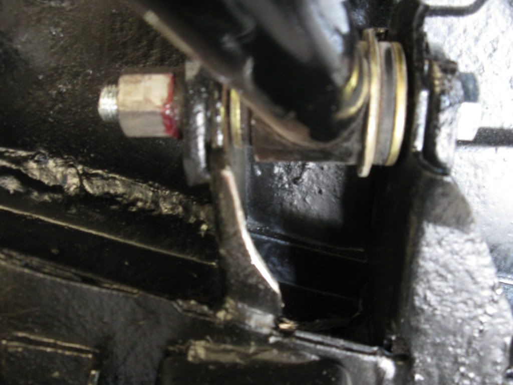

Coilover pics: 1 ear on the A-arm brackets needed trimming to clear the tubular arm:
You can see where the arm clears now:

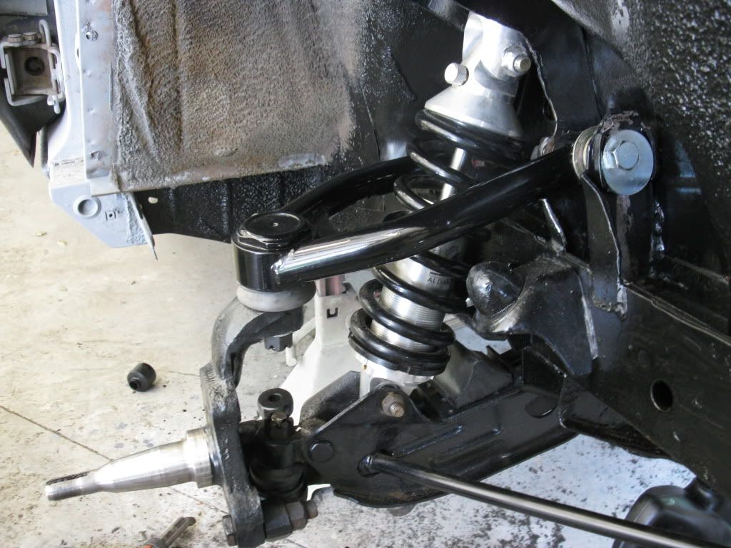

The coil just touched the bump stop brace, so it got a few whacks with the hammer:
The whole set up:
It needs a few more turns on the coilover to raise the nose, but this is how it sits:
Looks Great !!!!! Is it just me or did the first few pics disappear ??? What size tires and rims are you running ???
