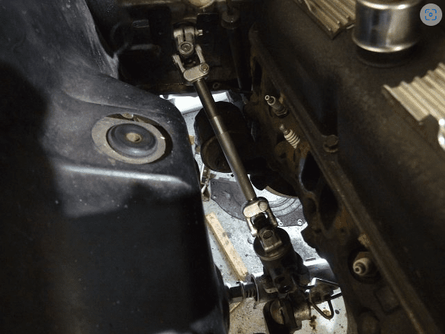

Move upper arm mount rearward to allow caster adjustment
by not putting the rack where you think i'm putting it :)

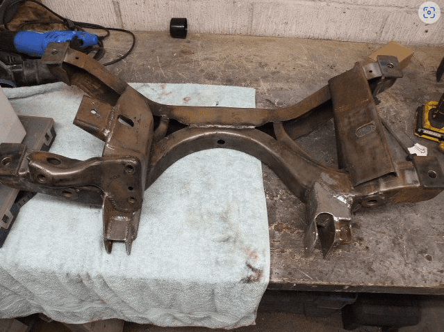

I've also centralized the engine

plus i moved the K frame for additional reasons as well so for me it makes more sense to do what i did.

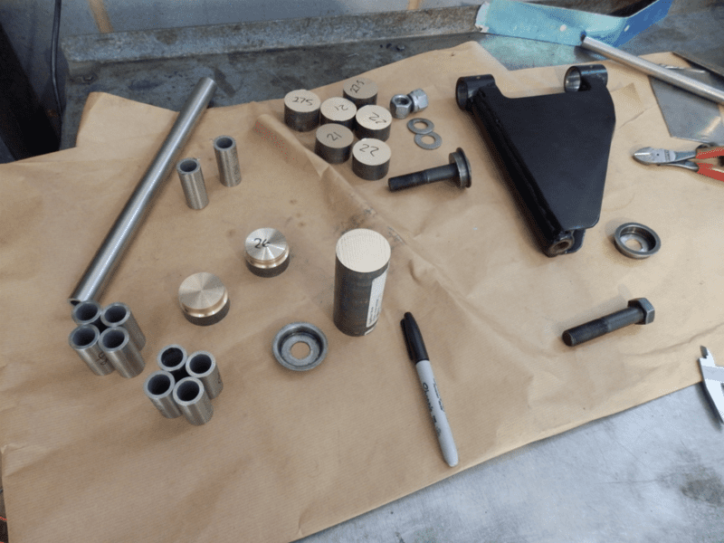

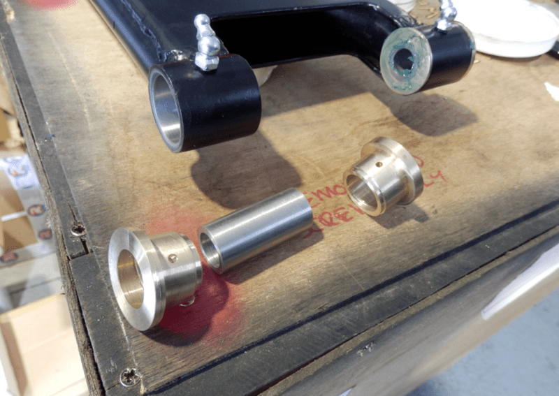

I have spent many hours fabricating, fitting and aligning bronze bushes for a 427 Competition Cobra's suspension arms.

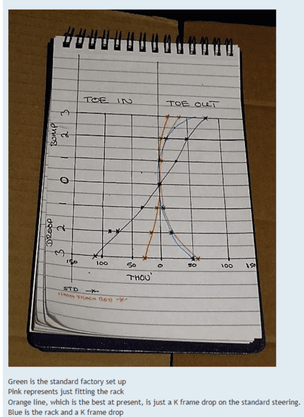

going back to caster change, when i measured bump steer on my '66 to see what the suspension does as it moves i found it changed Caster by 9 degrees from full droop to full bump and about 4 degrees over about 2 inches of suspension movement around ride height. (this was on old rubber bushes)

and this is what i found on bump steer

i think bump steer is actually built in to cause the steering to understeer as the car leans into a corner making it safer for the ordinary driver.
just dropping the K frame by 1/4 inch reduced bump steer in a straight line but i also tested it on a slight lock and bump steer is back.
UK roads are just awful for pot holes so for me dialing out bump steer and gaining more caster at a normal ride height is the goal.

Seems like you've induced an 'S' curve that looks more normal with 1/4" k-frame drop,. Explain 'slight lock'. And also, bump steer in chassis roll is affected then?
Setting that curve usually the best you can get.
Its all just compromising to get smallest amount of bump possible with a reasonable curve, right?
none of the measurements were done with the K frame moved forward. that idea was after i measured and got these results. The K frame drop reduced the 'S' curve, i could have probably dialed out the bump steer by leaving the K frame mounted to the chassis in it's original position and moving the steering box and idler arm.
the slight lock is just 1/2 turn on the steering wheel.
the steering box and idler arm are at an angle so turning the wheel lock to lock it effectively changes the height of the steering system in relation to the suspension. A steering rack is linear so doesn't have this effect on lock. i did all the testing with the original steering system, not a rack, and the reason two of the curves became a 'C' shape is because the steering link was shortened to the length that would be required to fit a steering rack (which would be too short to be ideal).
i don't have final measurements after the modifications yet but made sure i'll have enough adjustment to dial out bump steer once the suspension has the desired Caster and ride height set. Having done bump steer on many cars it doesn't take much, in as in as a little as a few thousandths of an inch, to raise or lower a steering rack to affect bump steer.
because i'm using spherical joints and ball joints on the lower arms then accuracy is easier to achieve, if it was all rubber bushed still then with all the movement available in the bushes under load accuracy will be completely lost to the point of why even bother.
