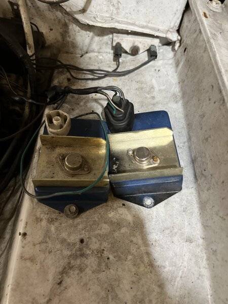

So the car went through 2 ignition modules in about 6 months. So I had the entire msd 6al ,ready to run distributor and coil on another motor in the shop. Installed it. Fired right. Went for a test drive and the wiring start to get hot. Does any have a clue as to what is going on. I personally think I need to just go with a one wire alternator. Any suggestions or opinions greatly appreciated

It’s a 69. Originally a 273 car. It wasn’t over charging before. (That I know of). I did replace the alternator right after the first ignition module went bad. The reason I went through the msd stuff is because I was having a problem with the connection at the ignition module which caused me to think it was bad
I have had some problems with the switch. Some times I have to kinda jiggle it to get the gauges to work. Sounds like I need to start there.
