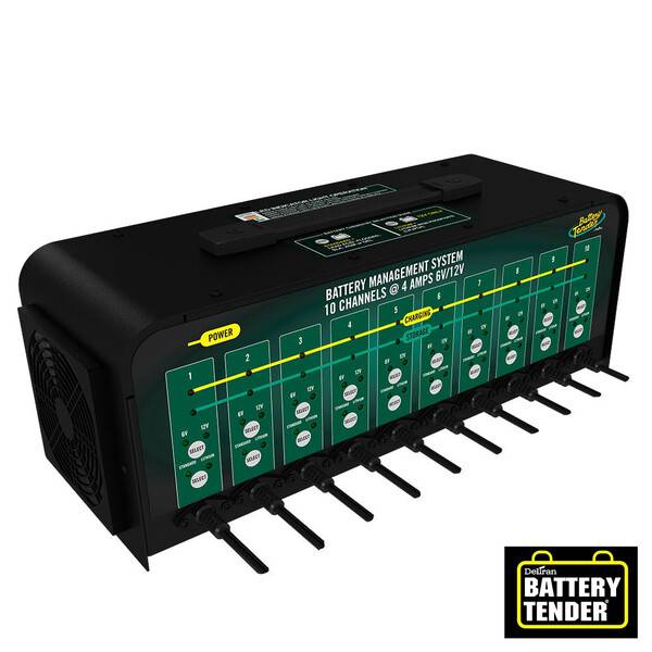

For those with deep pockets
Battery Tender® 10-Bank 6V/12V, 4 AMP Selectable Battery Charger

$999.95
