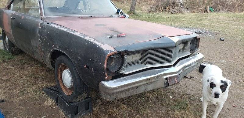

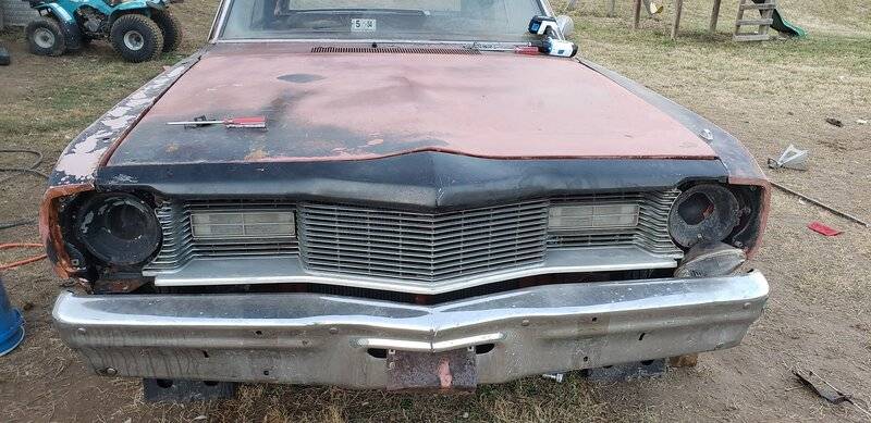

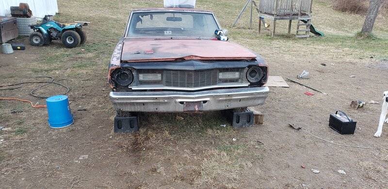

I got the fenders and "beak" on today im having a horrible time lining them up. Iv never been good at that lol
