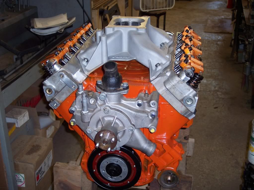

440 as it sits waiting for me to finish dressing it for install.
more to come... soon I hope... sucks having a full time job and trying to complete a project...

what all is done to it?
Thanks.Its a .030 over 440, blueprinted and zero decked. Balanced rotating assembly. Full floated KB's hyperU's, the cam is my own grind specs mechanicle full roller billet with intake and exhaust lift at .704, custom push rods from Smith's, Harland Sharp 1.6 roller rockers, 440 source heads with Rev valves and springs to match the cam, mopar intake and a Quick Fuel 850 on top. Should pull the 69 around pretty good..
Its not like I took them out of the box and walked to the engine and bolted them on, 704 is after 1.6
I gonna guess he knows more than lettin on.Cam specs?.I'll guess (at .050)intake 250 260,exh 262 270.You did more than a bowl blend.Pushrod restriction,guide streamling.Did you raise the roof?If not,280 to 310 at 28 inches.
we have already proven this combo. Makes plenty of HP/TQ with no oil issue. Did not run out of fuel or air either. thanks for the advice.

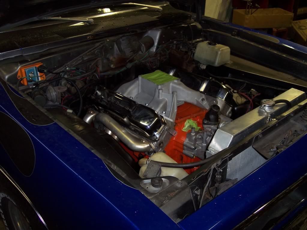

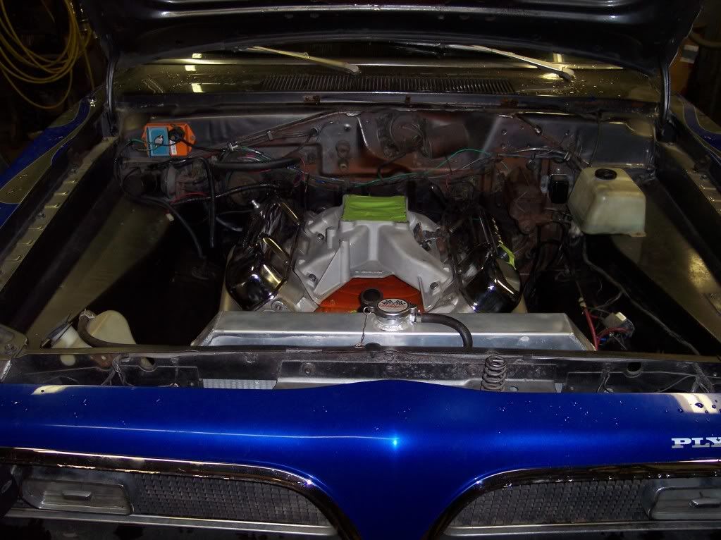

Engine and trans are in car. Hooked up the exhaust last night too... getting close. I'll try to put up more pics tonight.

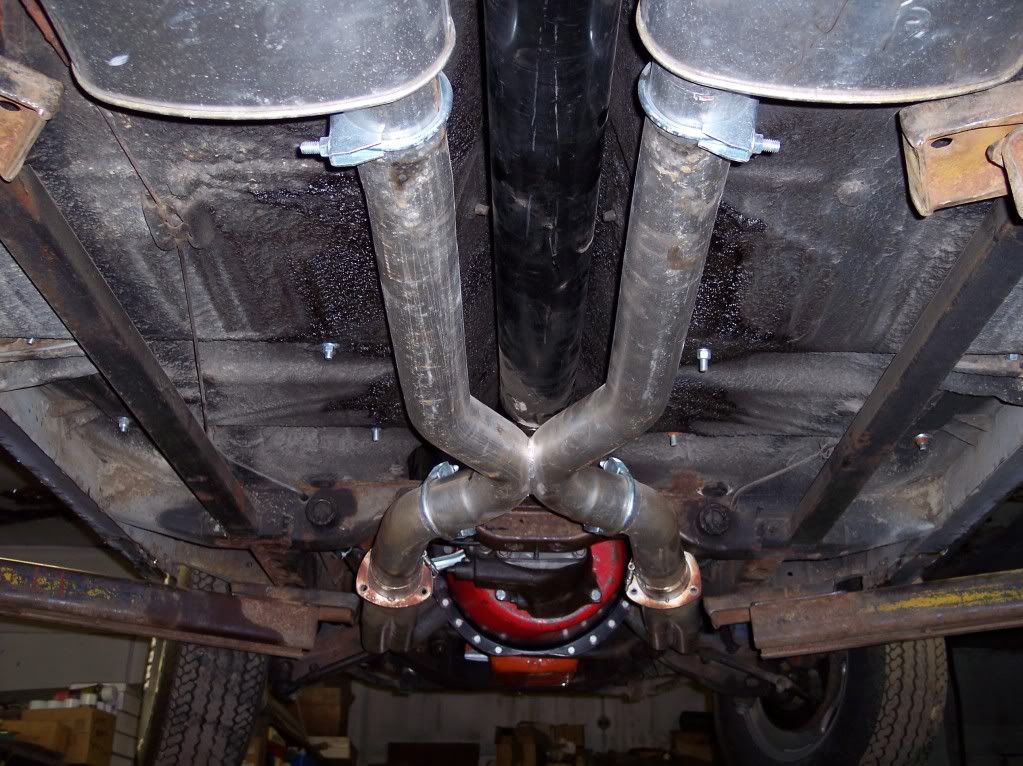

Curious about the header/4spd set-up. What headers are you runnin and how is the clearance for the Z-bar or are you going Hydraulic?
Running 2" TTI headers, you need to use the TTI Z bar or it wont work, I tried and almost decided to revamp the stock type Z bar to make it fit but after weighing out my time versus buying TTI's I bought theirs. I will say you wont believe it will clear to look at it before you install it but it does.
What is a Z bar? I have TTIs on my SB and like yours they angle inward. I am not sure how I will get them to fit the store bot 3" X pipe.
