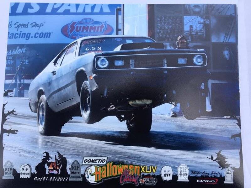

My 70 dart thinks she's fat.

Dominic which he goes by Thumper Dart has a Badass 70/71 dart swinger that is his street car. He races it once in awhile. If I remember right he has a pump gas low deck stroker 470. It's been a long time but I think he ran a 9.64 in the 1/4. But it is a true 9 second street car.
