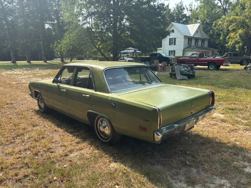

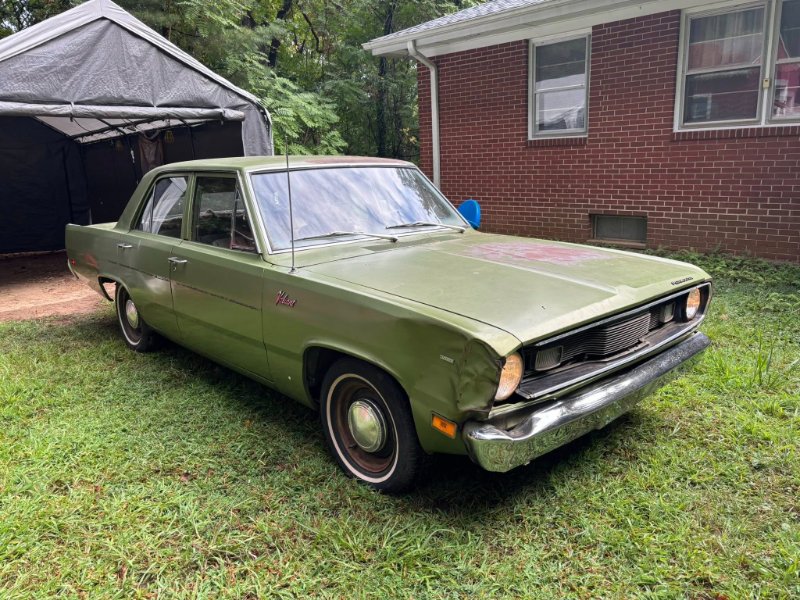

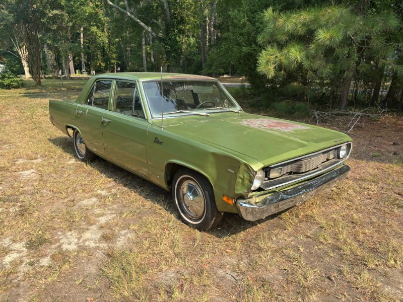

1971 Plymouth Valiant. 51k mile almost all original 318 V8 car with factory power steering and A/C, but manual drums. Was stored in a barn in Lynchburg VA and had some small stuff (side trim, one fender emblem) removed, and someone had busted out the driver front window, leading to chickens turning it into a temporary chicken coop. Someone had also backed into it at one point and crumpled the fender/bumper. Interior needs a lot of help, but the only rust I’ve found on this car has been in the front floor pans, and they’re not large enough to be really concerning to me. You can tell from the pictures, but the rest of the car is stupid solid!

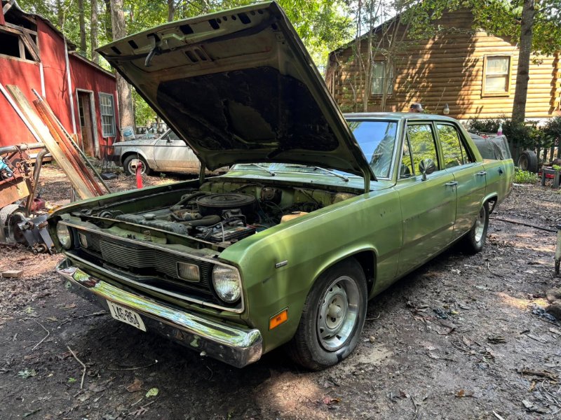

This was how I first saw the car in Spring 2024. My buddy kept the SBP Rallyes but they look really good on it.

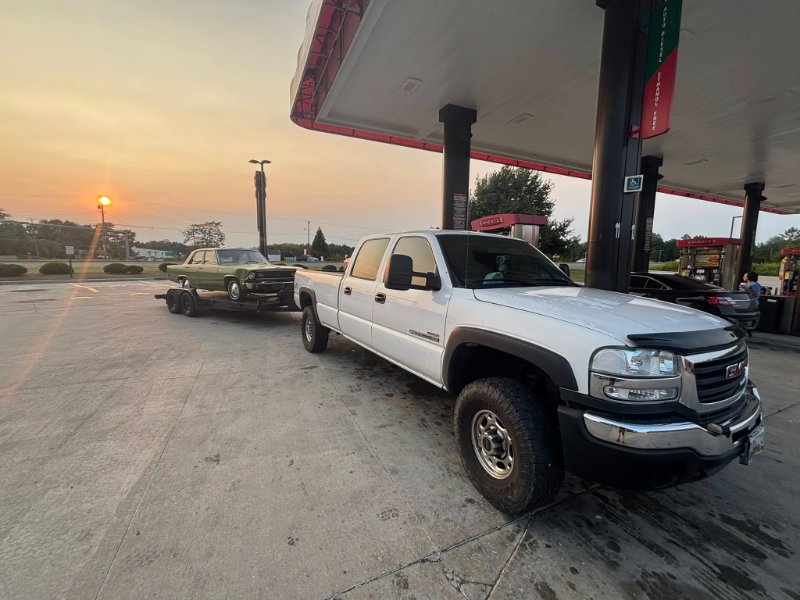

Had a close friend help me bring it home (he knows how to drive with a trailer).

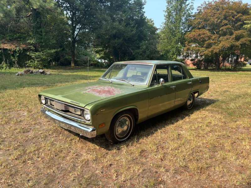

Now some pictures in the daylight.

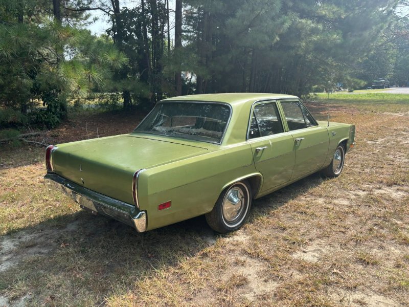

Obviously the money shot side.

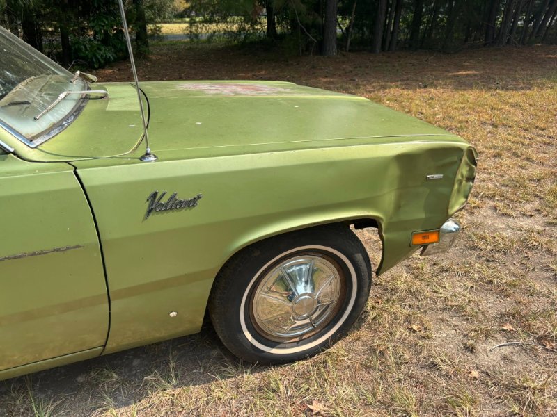

The not pretty side...
It's a shame because this fender is otherwise solid. I did talk to a friend of mine who specializes in rusty metal and he thinks he may be able to get this banged out.

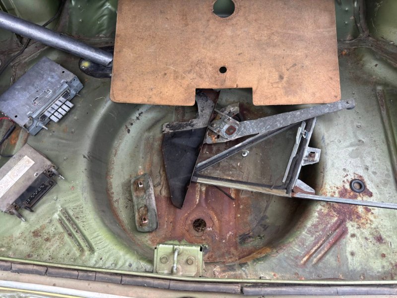

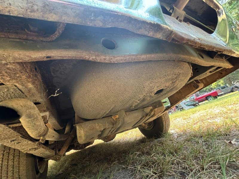

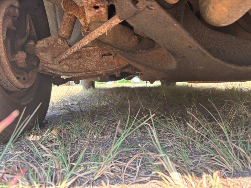

Crispy underside, very original, and very rot free.
More rustlessness

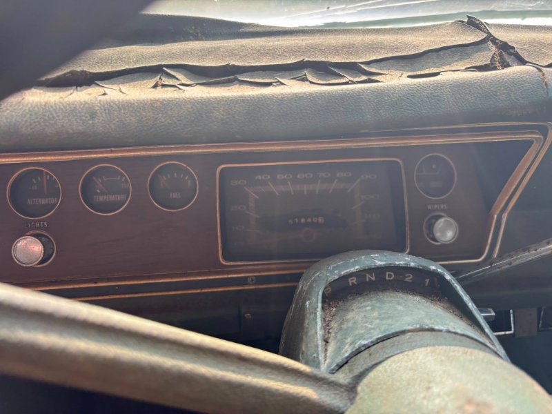

51,846 miles on the odometer, and judging by the originality, it is accurate.

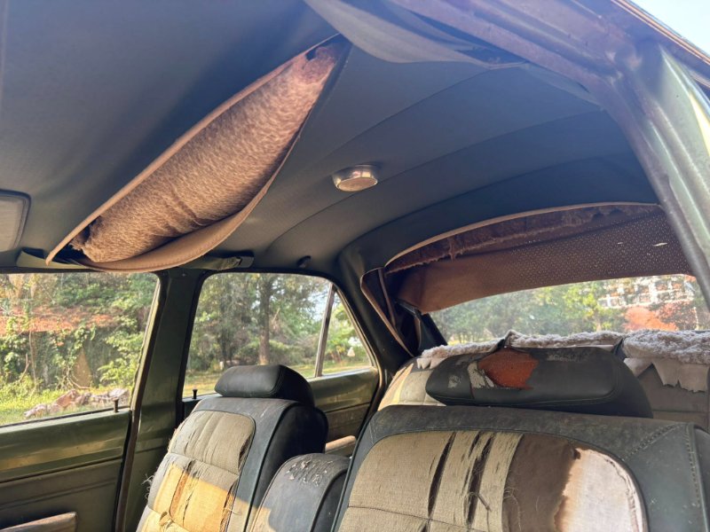

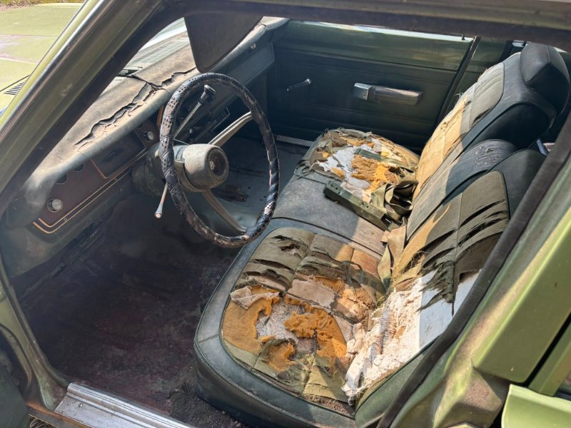

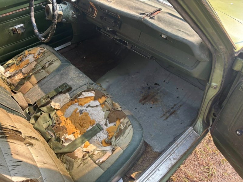

Some more initial pictures. Interior is in need of alot of love, but that is what happens when it becomes a chicken coop (or sedan?).

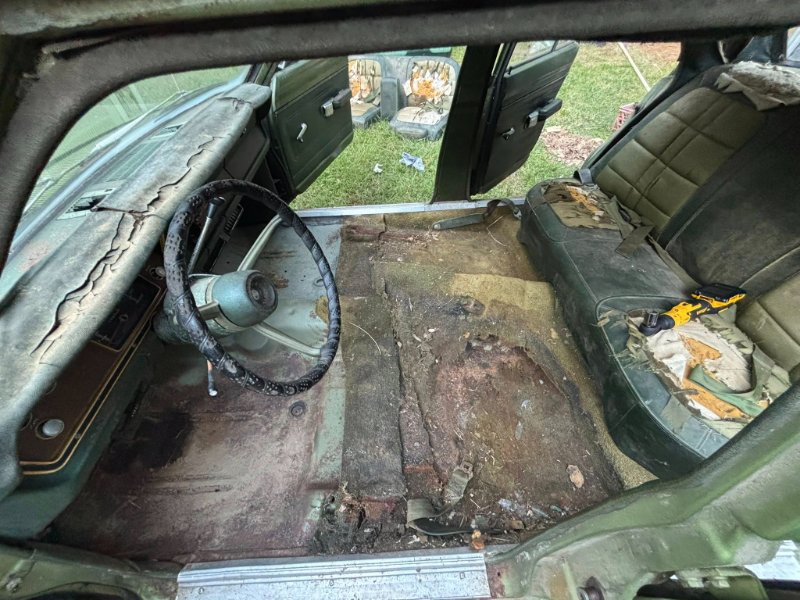

Small holes in both floors, plan of attack will be neutralize rust and fiberglass it.

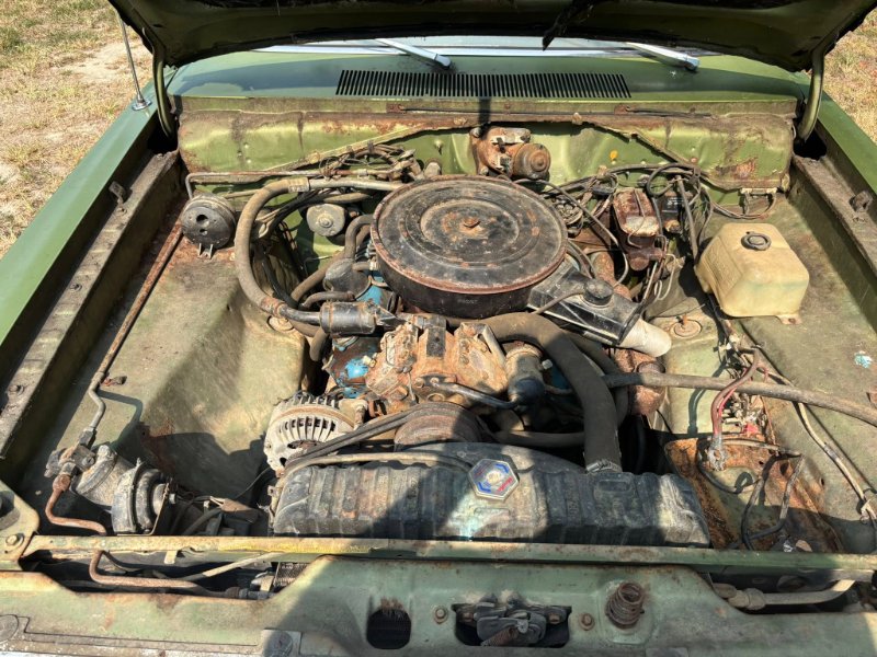

Basic and original 318 2bbl. Was excited to see that it has the better cooling package because of the A/C (thicker rad, 6 blade fan with clutch).

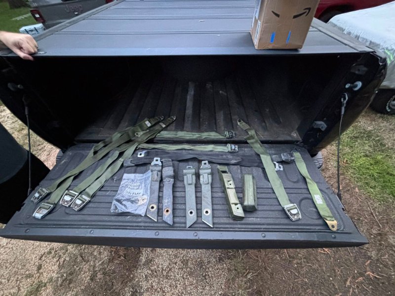

And then my eBay find- a full (or close to full) set of correct green seat belts from a 1971 Dart sedan. Unfortunately almost every female buckle is missing the plastic.

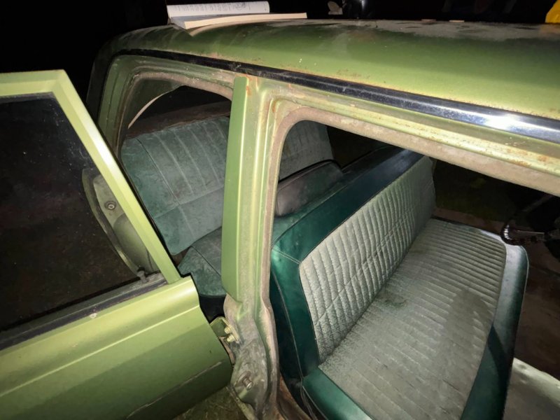

Decided the best motivation was to get at it and start cleaning, and I wanted to see what other treasures were hiding (I knew of one in plain sight), so we got to work.
Honestly alot cleaner than I anticipated. It will get the same treatment my 1971 Polara got on the floors, but it was alot more solid that I thought it would be.

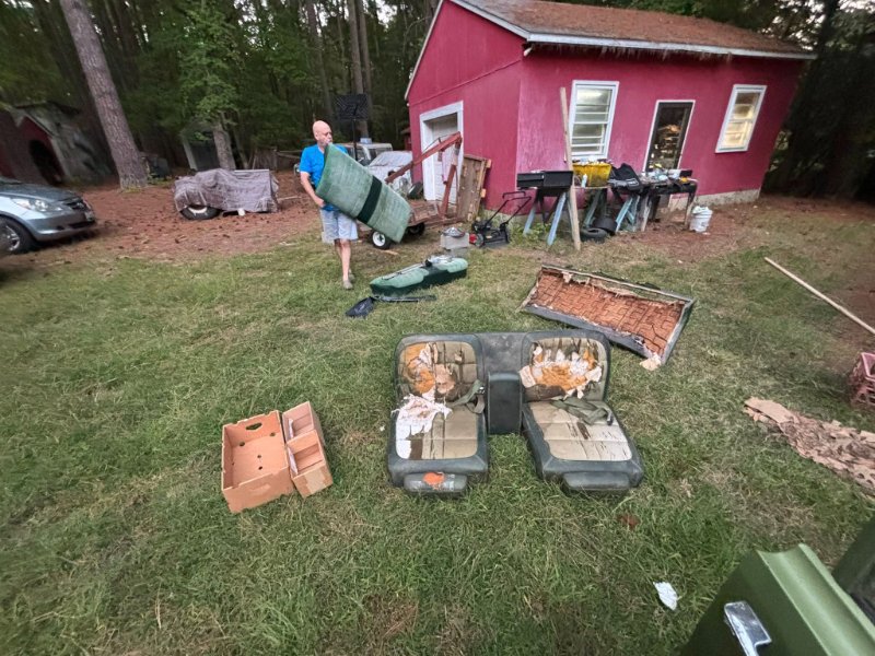

Old seats out, new seats going in. Peep my Polara and D150 in the background. In the post above you would have seen my W250 and Shelby Dakota...I am a Mopar addict.

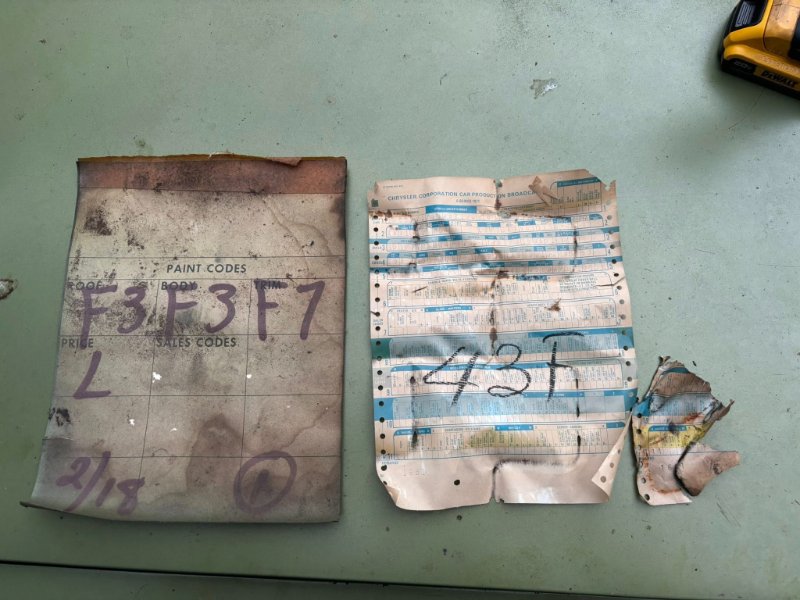

Treasure number 1- full broadcast sheet in the rear seat back. I could see it through the rear window, and it is severely sunfaded but complete.
Treasure number 2- remnants of another broadcast sheet in the front seat bottom.

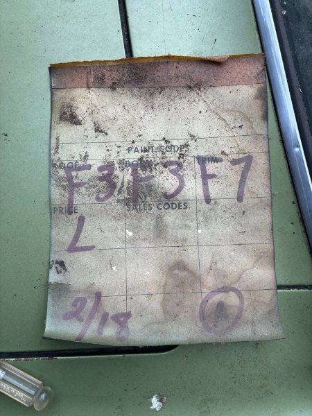

Treasure number 3- a true factory build sheet! I have not seen another.
All the goodies together. Also found a AAA membership renewal from a past owner (who unfortunately passed but in a weird way, passed a week after my little brother was born) that confirmed where the car was from (Roanoke/Lynchburg Va area). I have reached out to some next of kin and hope to hear back from them.

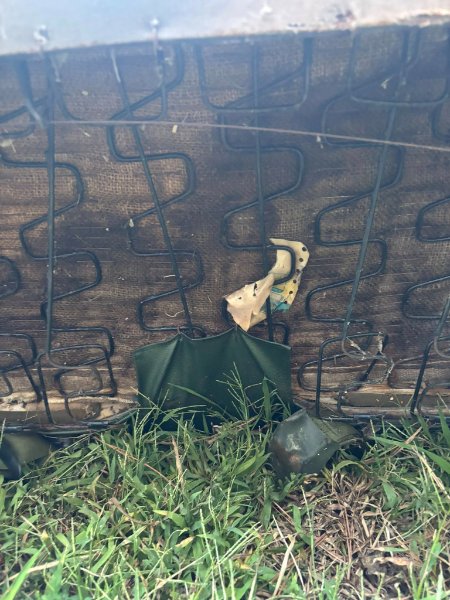

New seats in! Front seats have to come back out because one of the tracks is rotted, so I have to swap over the ones off the original seats (it also has a seat spring that is creaky). Learned that Mopar changed how the rear seat backs attached, but its nothing some self tappers can't fix. And yes, before you say it, they are the wrong shade of green, but they will be covered with a cheap Mexican blanket seat cover for the forseeable future. Remember- 16 year old's first car.

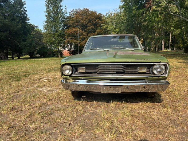

A face only a mother could love. But a face I like to see every time I walk in the tent.
