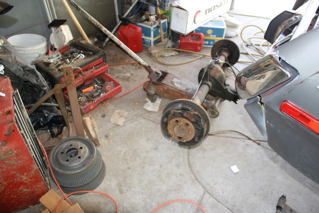

So good news! A friend let me "borrow" some 8 3/4 shock plates. He said i can use them but have to replace them. And im not sure if i mentioned it yet but my uncle said he has a "pile" of driveshafts and i could have one for free. So ive decided to stick my rear in and see how long my driveshaft needs to be. So it begins! I actualy got the rear out tonight but it was too dark for any more pictures. Ill get some more tommorow. anyway heres what i got. Im currently using an overhang thats next to my garage as my garage. My dads using the garage, anyway heres some pictures. Oh these are only cell phone pictures so they are pretty bad. Ill get some nice pictures on my digital SLR camera tommorow.
So here are some of the pictures i promised. The car actualy had a wimpy 7 1/4! my toyota has a bigger rear end!
