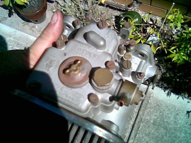

How about a Dcoe weber and 90 degree runner matched to the origonal manifold (45 or 48, whatever turns up on ebay at the right price) with filter finishing just in front of the water pump in the engine bay.

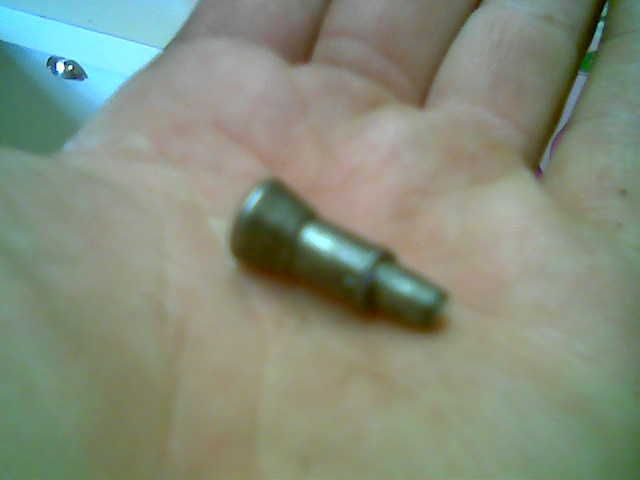

Hahaa, i found the miss i've been looking for :) (that's the top of a pushrod, sorry for the dodgy photo)

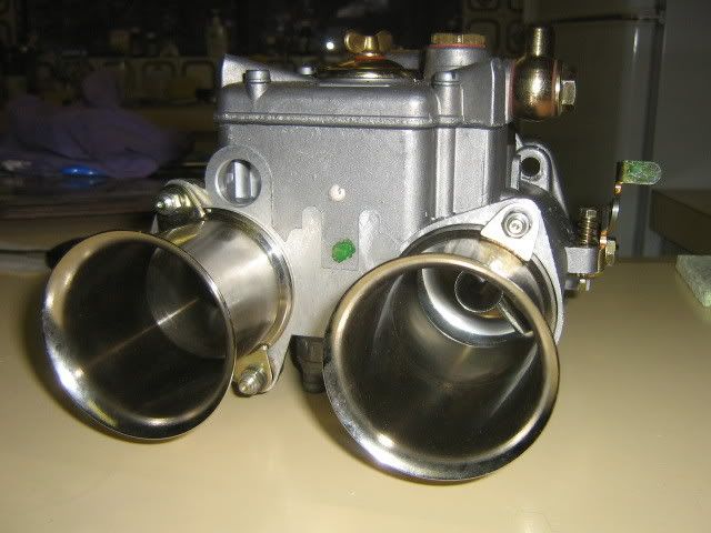

will throw progress shots of the carb modification soon too, here's the carb that's going on
Well it turns out the bit of lifter in the valley was from an earlier repair, heres the cause of my miss :)
bent pushrods suck! i should know. i say fix what you have and save the monster cam for another setup. those wheels look great on that car, who makes them?

HAHAA my tax return dollars at work arrived in the mail today, i wasn't the keenest on braking up my set of rt webers (45mm)
so i was fortunate enough to snag an as new 48mm today
manifolds almost tig'd up, will throw up snaps when sorted (hopefully this weekend)
i know it's a tad different, but i'm sick to death of seeing the same old stuff at runs, and of course the sound that these carbys make is HORN imo.
