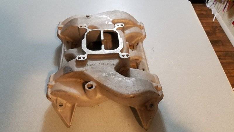

Attached are photos of a "B" aluminum
intake that I am looking at.
The Chrysler part # is 2836148.
Does anyone know anything about it?
Thanks
Just found a pic of mine for a 383. It is 2636149 from the look of it.
I don't know for sure, but it almost looks like the equivalent to an LD340 for small blocks.
Thanks!
A member on FBBO said he thought it was a dead ringer for the Edelbrock CH4B. If it's the same intake then I figure Edelbrock manufactured it for Chrysler. I was looking at it [it's on ebay] for my 383, but I need low torque and the CH4B is a higher torque intake and is soft on the bottom end. The guy is asking $225 [obo] + $40 for shipping. It would be too salty for me anyway.
Thanks!
Wrong, wrong wrong. The DP4B and Ch4B intakes are all about bottom end. This intake is a DP4B made for B block engines. (350,361,383 and 400) They are not for the RB engines. (413,426 wedge, and 440) These intakes are VERY good street intakes with lots of bottom end and flow to 5500 or so.
Wrong, wrong wrong. The ch4b small block intakes are all about bottom end. This intake is a DP4B made for B block engines. (350,361,383 and 400) They are not for the RB engines. (413,426 wedge, and 440) These intakes are VERY good street intakes with lots of bottom end and flow to 5500 or so.

It's a dual plane intake. They are designed for low Rpm power and torque.
The Tarantula is a high rpm street/strip intake. If you are going with 4.10's I wouldn't be concerned about low rpm power. What is your combination and what are you trying to accomplish?
To me, the CH 4B is an alum version of the factory iron one. Or very similar. They are good for low and mid range torque. At High RPMS, the TM 6 would work better.
DP4B.. The CH4B is for the RB's
This the article? If so, you're reading way too deep into the soft comment. Especially considering that was on a pretty much all out, 12.5:1 on race gas engine. That's a completely different animal and those manifolds are gonna have different results on a lower compression engine with different heads and cams.
